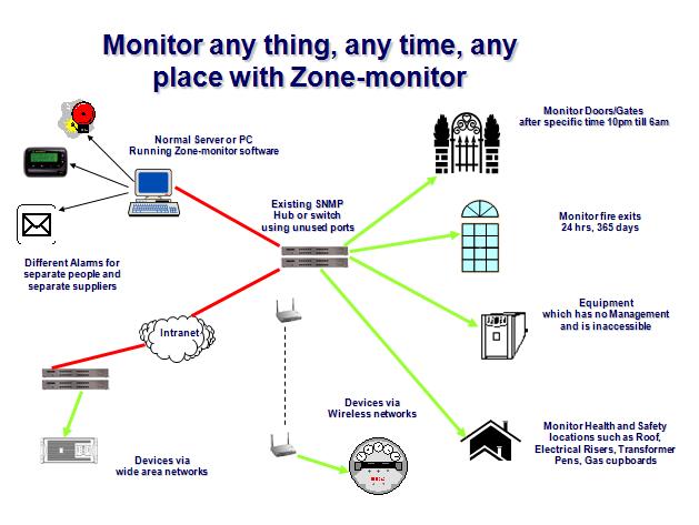

Introduction: Home 10 Zone Monitor/alarm System Using SNMP Ethernet Hubs.
This is my first instructable, so hope is of interest.
This 10 zone monitor or alam system, is done using a low cost IP snmp hub and Windows based PC running snmp software from commercial outlet but in freeware 10 node version. You can have as many zones as you have snmp ports, the restriction is the freeware version of "serversalive" product I have used. The instructions below are for 6 ports, just duplicate for more zones etc.
I devised this system to help ensure various doors, fridges etc in house where closed/ locked as my young childern kept leaving them open ?
This software can raise many alarms from windows popup and email to IQU among others. The software also has schedule software so you can have automatic polling of zones, and each zone can have different alerts. The alerts can be seen on pc or as web pages.
I have used a 3Com PS40 24 port ethernet hub which has SNMP built in, but have tried on various Cisco Nortel and others. The instructable will help you build the interface and guide you through getting the Windows PC (XP) talking to unit and which options to poll etc.
