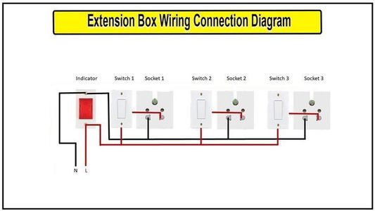

Step 1: Design the Box With Buttons and Sockets
First image is the internal circuit connection of second image(connection between buttons and sockets) and we have to attach the stepper motor slider just above these buttons.
