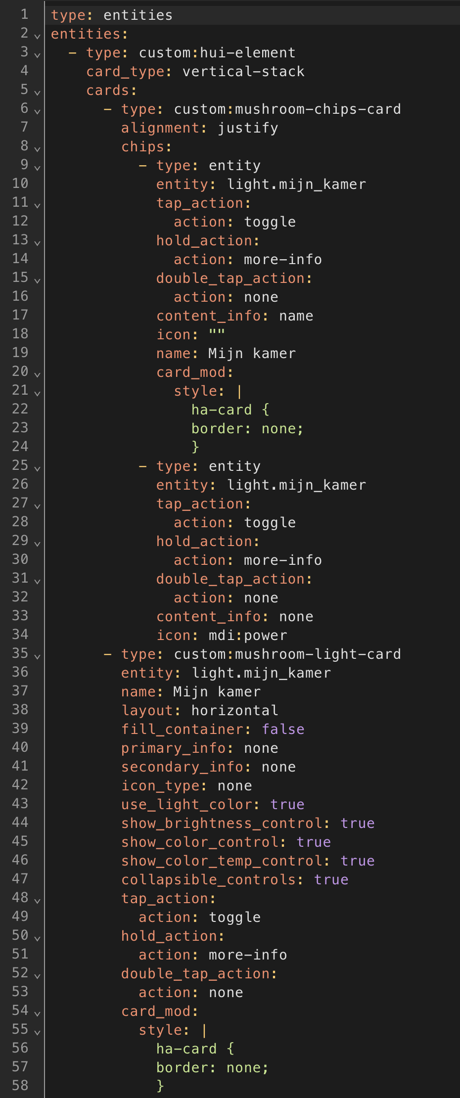

Step 2: Adding the Card
This slider makes use of the mushroom chips and mushroom light cards. These are both put into a vertical stack card that provides home assistant itself.
The chip card is used for the light title and the on/off button.
The light card is for the light entity.
Because you already put these two cards in a vertical stack, you can add as many of these "pairs" as you want to. In my case I used 9 lamps which one of them is not capable of using the RGB colours and temperatures. It works just fine! The slider then represents the brightness only.
You can experiment with all the parameters of the mushroom mod to make it as good as you want!
Step 3: Debugging
If it does not work, make sure the card mod plugin is installed. If not, you can delete these lines:
card_mod:
style: |
ha-card {
border: none;
These lines will remove the borders around the cards. This looks extra good in my opinion.
