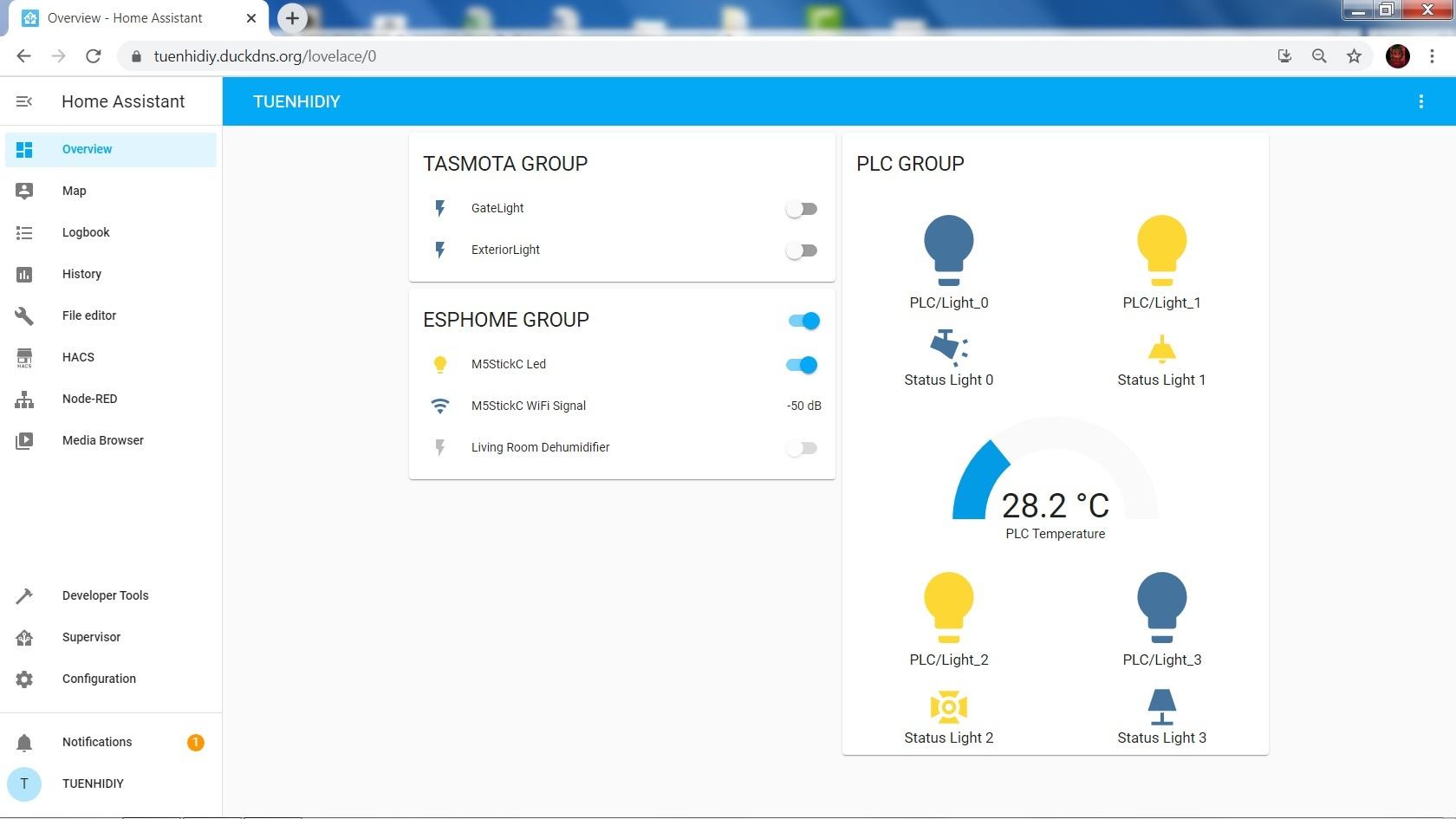

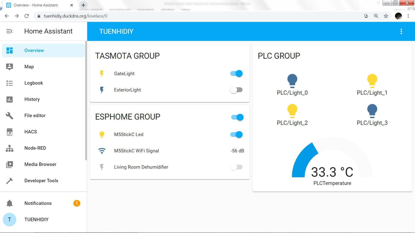

Step 3: Project Descriptions
There are 3 device groups in my Home Assistant Dashboard, as follows:
1. TASMOTA Group, including:
- Gate Light is controlled by one Tasmota - SONOFF Basic.
- Exterior Light is controlled by other Tasmota - SONOFF Basic.
2. ESPHome Group, including:
- M5StickC shows led control and WIFI level on dashboard.
- NodeMCU ESP8266 control one Dehumidefier, it's just an example because I don't have it.
3. PLC Group, including:
- Four PLC lights can be controlled from Home Assistant dashboard.
- One PLC PT100 temperature data is monitored on Home Assistant dashboard.

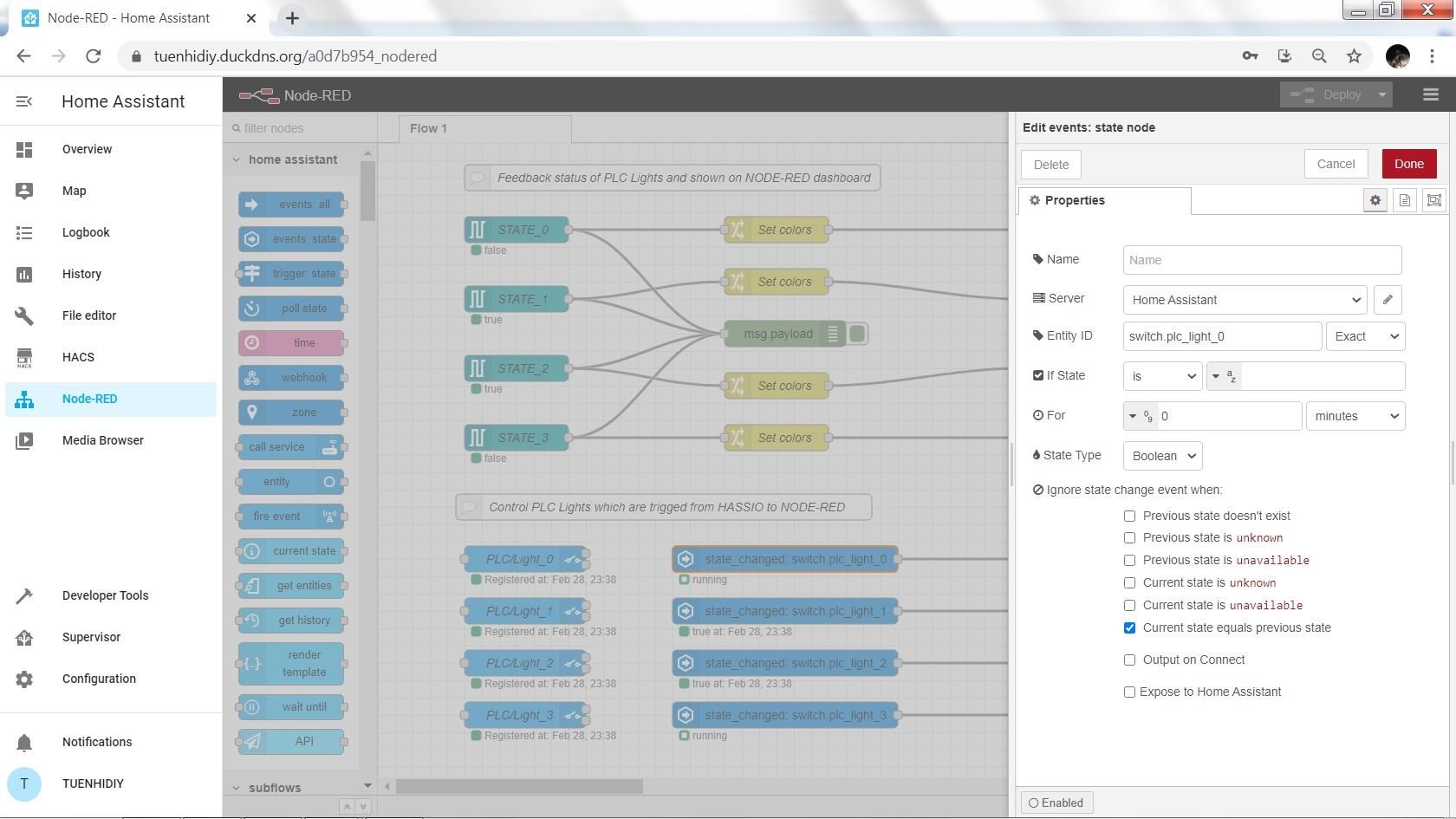

Step 8: Node-RED, HACS & PLC S7-300
Firstly, we need to install following extensions:
- Node-RED extension node-red-contrib-s7 need to be installed to interact with Siemens S7 PLCs.
- Custom Component for node-red-contrib-home-assistant-websocket to help integrate Node-RED with Home Assistant Core.
1. Control 4 PLC lights from Home Assistant:
In order for the PLC Lights to be controlled by Home Assistant, I used the node-red-contrib-home-assistant-websocket extension to generate the switch entities from Node-RED.
- Selecting "entity" node.
- Choosing Type: Switch.
- Filling in the name field in the Home Assistant Config (optional): PLC/Light_0.
- Payload: $entity().state ? "on": "off"
- Do the same with 3 remaining switches: PLC/Light_1, PLC/Light_2, PLC/Light_3.
After deploying in Node-RED, go to Home Assistant ‣ Configuration ‣ Integrations ‣ Node-RED, we can see 4 light switch entities appear here which have just generated from Node-RED.
- Name: PLC/Light_0 ‣ Entity ID: switch.plc_light_0
- Name: PLC/Light_1 ‣ Entity ID: switch.plc_light_1
- Name: PLC/Light_2 ‣ Entity ID: switch.plc_light_2
- Name: PLC/Light_3 ‣ Entity ID: switch.plc_light_3

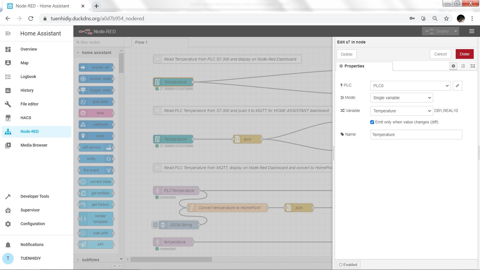

Due to each "switch" entity node in Node-RED has 2 outputs (true and false), so I used "events: state" node to cactch the state of each switch.
Finally, output of "events: state" node is connected to "s7 out" node and "s7 out" node is configured to control logic state of lights in Data Block 1 (DB1) of CPU S7-300.
We can see "switch.plc_light_0" entity ID is finally connected to "DB1, X0.0" in Node-RED. Back to previous step, in PLC, it is define "DB1.DBX0.0". Take note this discrepency.
From "s7 out node" ‣ Go to "s7 endpoint node" ‣ Tab "Connection":
- Transport: Ethernet (ISO-on-TCP).
- Address: 192.168.1.71 - Port: 102. Back to previous step, this is the PLC's IP address which I configured in NetPro.
- Rack: 0 - Slot: 2.
- Name: PLC0.
From "s7 out node" ‣ Go to "s7 endpoint node" ‣ Tab "Variables":
- DB1,X0.0 (In PLC: DB1.DBX0.0 control Light 0 at Output Q124.0).
- DB1,X0.1 (In PLC: DB1.DBX0.1 control Light 1 at Output Q124.1).
- DB1,X0.2 (In PLC: DB1.DBX0.2 control Light 2 at Output Q124.2).
- DB1,X0.3 (In PLC: DB1.DBX0.3 control Light 3 at Output Q124.3).
- DB1,REAL10 (In PLC: DB1.DBD10 store temperature in floating-point).

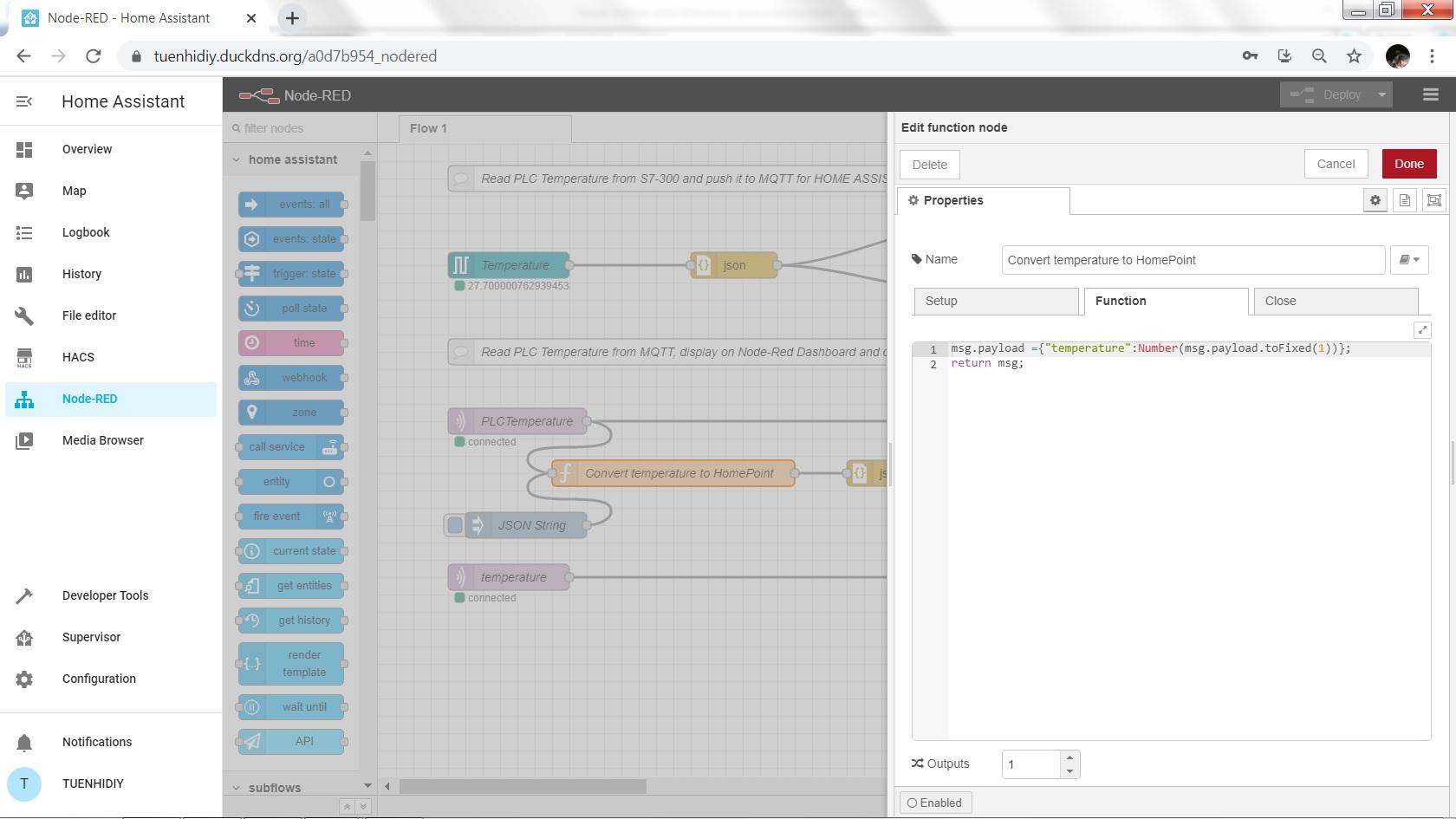

2. Monitoring PLC PT100 temperature on Home Assistant dashboard and HomePoint screen.
The Node-RED flow is shown below.
The PT100 temperature (DB1,REAL10) is read from "s7 in" node and published to MQTT Broker at "mqtt out" node. Then it can be displayed in the Node-RED dashboard or Home Assistant dashboard by subscribing from the MQTT Broker.
The "mqtt out" node is configured as follow:
- Server: MQTT-TUENHI
- Topic: PLC/Temperature
- QoS: 0 - Retain: false.
- Name: PLCTemperature.
From "mqtt out" node ‣ Go to "mqtt-broker" node and set up "MQTT-TUENHI" is a MQTT Broker.
- Server: 192.168.1.14. (This is IP address of Raspberry Pi).
- Port: 1883.
Since I have already installed the Raspberry Pi (IP address: 192.168.1.14) as a MQTT Broker in Home Assistant, so we can set up Node-RED to use it for publishing and subscribing all topics from connected devices.
If we forgot our MQTT username & password at "Security" tab, they can be found by going to the Home Assistant ‣ Supervisor ‣ Dashboard ‣ Mosquitto broker ‣ Configuration.
In order to display PT100 temperature on the HomePoint screen, I had to convert this temperature data into HomePoint format.
And publish one more topic, named "temperature" to MQTT Broker just for HomePoint.
In the next step, we will know how Homepoint can read this value and display it on the M5Stack Core 2 screen.

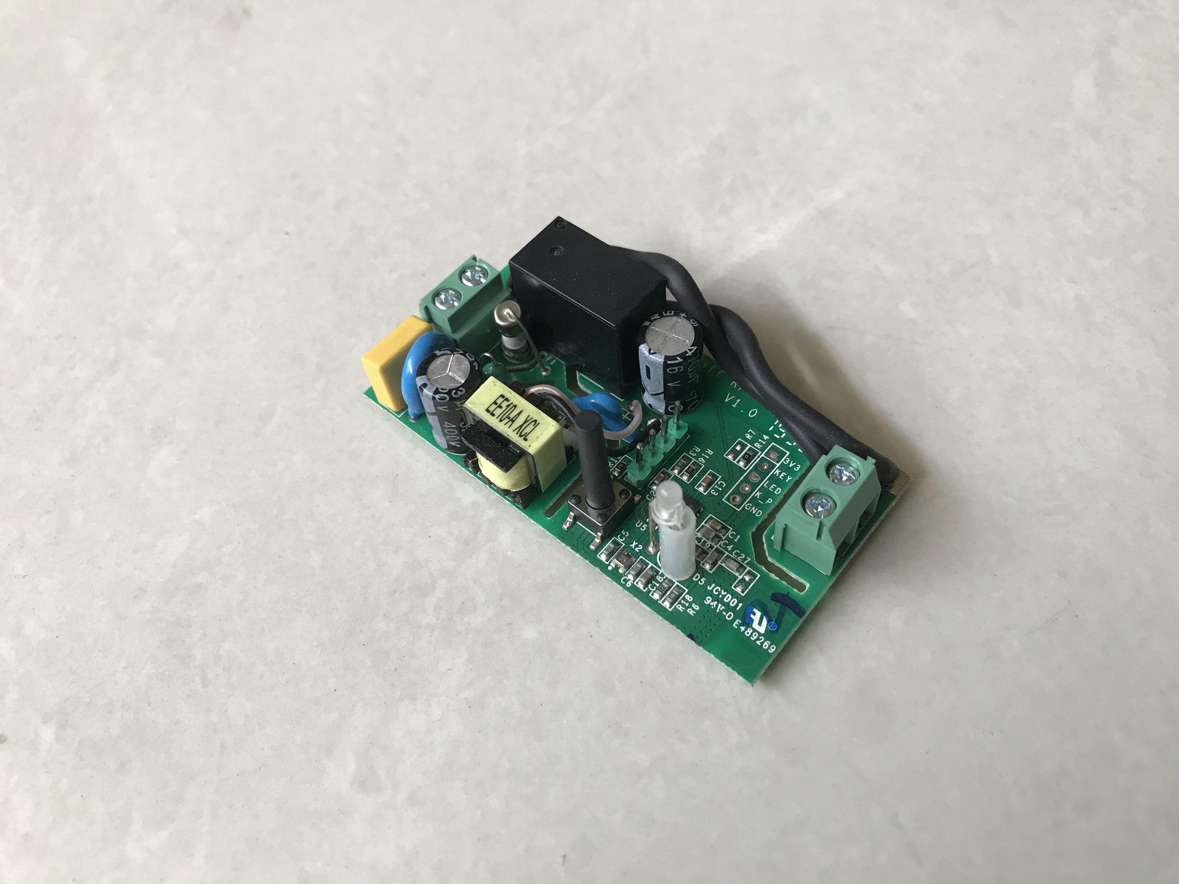

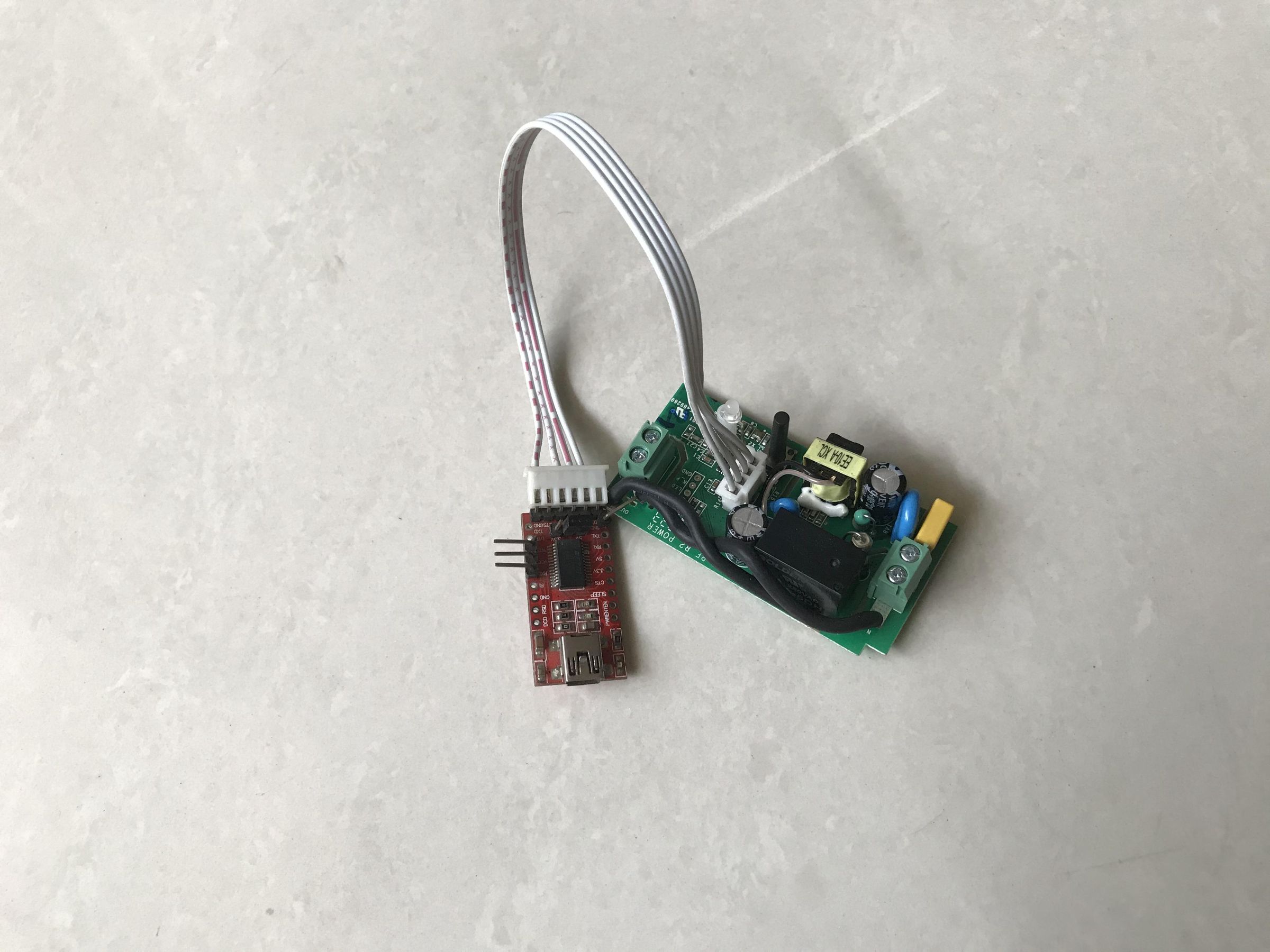

Step 9: Tasmota & SONOFF
To flash Tasmota firmware for SONOFF, I did the following steps:
- Downloading the lastest releases Tasmotizer.
- Opening SONOFF case and soldering 4 pins male header at reserved 4 pin holes on PCB.
- Connecting SONOFF header to FT232RL by a XH2.54mm – 4P 10/20cm wire cable double connector. Take note the connection should be correct (3V3/ RX/ TX/ GND).
Connecting FT232RL to the laptop, opening "tasmotizer-xx.exe" in Windows:
- Select port: choose correct COM port.
- Select image -> Release (select from a list of available release binaries): tasmota.bin.
- Select some options based on your need, like: Backup or Erase before flashing...
- Click Tasmotize! and wait until done.

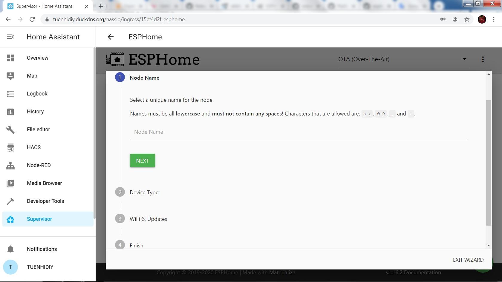

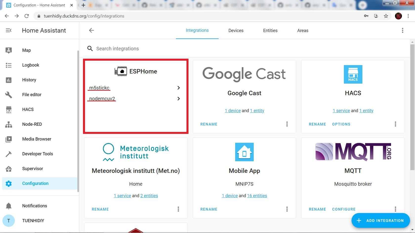

Step 10: ESPHome & NodeMCU ESP8266 – M5SticC
1. Download ESPHome-Flasher following your PC operating system.
2. To install ESPHome for NodeMCU ESP8266, we did as follows:
- Firstly we navigate to Home Assistant ‣ Supervisor ‣ ESPHome ‣ OPEN WEB UI ‣ Click on the “+” icon to add a new device.
- Enter 'Node Name' ‣ Select correct 'Device Type' ‣ Enter WiFI SSID,WiFi Password and OTA Access Password in 'WiFi & Updates'.
- Click ‘Edit’ on menu device to edit a YAML file currently configured for NodeMCU.
- Click 'Compile'.
- When the compilation completes successfully, click on ‘Download Binary’.
- Open ESPHome-flasher.exe, select correct 'Serial port' and browse to firmware which has just complied, click 'Flash ESP'.
- Go to Home Assistant ‣ Configuration ‣ Integrations ‣ ESPHome, we will see that NodeMCU ESP8266 has already been discovered by ESPHome.
3. Since M5StickC hasn't been supported officially by ESPHome, so I referred to below projects to configure it by custom files.
https://github.com/airy10/esphome-m5stickC
https://esphome.io/cookbook/leak-detector-m5stickc
Finally, both NodeMCU and M5StickC have already been discovered by ESPHome.

For PLC temperature value, as mentioned on previous step, before pupblishing it to MQTT Broker from Node-RED, I had to convert it to HomePoint format, something like:
{"temperature": 56.7}

Step 12: Showing Cards on Home Assistant Dashboard
For TASMOTA GROUP & ESPHOME GROUP, we can easily add them to dashboard by Entities Card supported by Home Assistant.
Home Assistant did not support to add gauge card and button card into one group, so I had to do following steps to create PLC GROUP:
- Installing 'Stack In Card' in HACS, it allows to group multiple cards into one card without the borders in vertically and horizontally.
- After installing, then we can see it at Home Assistant ‣ HACS ‣ Frontend.
- Typing below codes in Card Configuration ‣ Show Visual Editor
type: 'custom:stack-in-card' title: PLC GROUP mode: vertical cards: - type: horizontal-stack cards: - type: button entity: switch.plc_light_0 icon_height: 50px - type: button entity: switch.plc_light_1 icon_height: 50px - type: horizontal-stack cards: - type: button entity: switch.plc_light_2 icon_height: 50px - type: button entity: switch.plc_light_3 icon_height: 50px - type: horizontal-stack cards: - type: gauge entity: sensor.plctemperature min: 0 max: 100
- PLC temperature gauge and light switches are grouped together.
Now my home devices and industrial PLC equipments can be controlled and monitored by Home Assistant dashboard.
Finally, I have added 4 feedback signals from the PLC indicating 4 lights statuses. These feedback signals are published to the MQTT Broker.
Then Home Assistant get and display them on the dashboard. They confirm the lights ON/OFF commands.
Step 13: Node-RED Dashboard and Home Assistant Dashboard
We can use 'Webpage Card' to embed the Node-RED dashboard page into the Home Assistant dashboard.
- Firstly, we add 4 toggle buttons to control the lights in the Node-RED.
- Deploying in Node-RED, and go to Node-RED dashboard, now we can control all lights here.
- Node-RED dashboard can be embedded into Home Assistant dashboard by using 'Webpage Card' as below picture. It is not bad solution!
