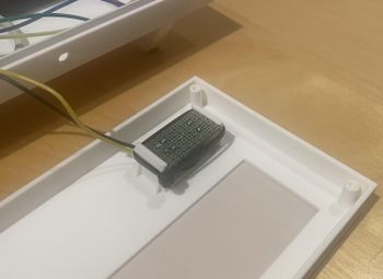

Step 2: Push Button Assembly
Cut a piece of verobord/stripboard to a size of 10x5 holes (see image), length should be around 28.5 to 29 mm. The connection lines on the board should run along the longer side of the board (horizontal if the board is oriented as in the image). Solder the push button to the middle of it. Then solder two wires, appr. 150 mm long so that they connect to the two button connectors on one side.

Tip for mounting the button
It can be difficult to cut the veroboard exactly so that it snap-fits into the case top. If your board is a tiny bit too short, use a zip-tie to pull the mounts together so that it grips the veroboard, as shown in this image:
