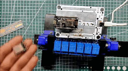

This is a Home Automation Board that is based around the NODEMCU ESP8266 Board and 6-channel relay.
This Board is controlled locally by accessing its web app via any browser, it can control 6 different outputs currently but we can add more, and it's easy to change the code for extra outputs.
The goal of this project is to make an easy and simple Home Automation System that anyone can make and learn by following a few simple steps.

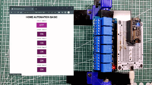

Step 2: RESULT
  • After Uploading the Sketch, we open the serial monitor and wait for the ESP to get connected with the local WIFI network.
  • you will see the Local IP Address when the ESP gets connected to the Network, copy this IP Address and open it in your browser.
  • We can now toggle the LED by pressing the button in the web app.

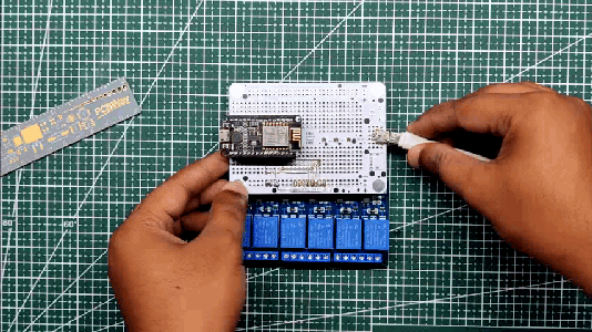

Step 3: NEXT STEP, Prepare a Custom Setup With PCB BREADBOARD
After finalizing the Breadboard setup, we prepare the main PCB for this project that will be made on a custom PCB Breadboard.
PCB Breadboard is a custom board that I have developed for quick prototype work. it consists of holes arranged in the same form factor as a regular breadboard.
Each hole is 2.54mm away from each just like in the physical breadboard and header pins.

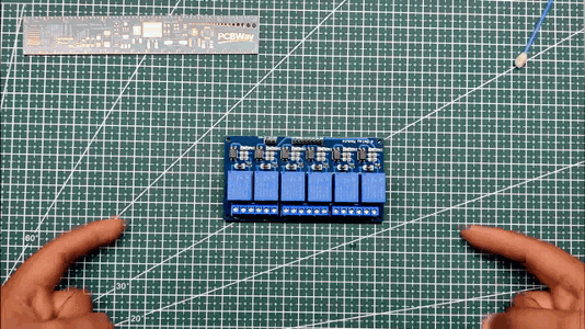

Step 4: RELAY MODULE
Here's the component that does the main work of controlling the AC or even DC Load, the 6 Channel Relay Module.
The 6-way relay output module contact capacity is 10A 250V so it can handle any load under the 2500W threshold.
Input uses a LOW Signal to work and toggle the relay ON and a HIGH signal for turning the relay OFF.
It contains 6 RED LEDs that are each connected with an optocoupler which controls the N-Channel transistor's gate, this transistor then turns the ON or OFF the Relay.
Each Relay is connected with the same setup that consists of an OPTOCOUPLER and TRANSISTOR controlling the RELAY.
I have created a schematic for this relay module by following the traces with help of a multimeter, you can use this schematic to remake your Relay Module.

Step 7: MAIN ASSEMBLY
  • We start the main assembly by first adding the Female Header pin connector to ESP8266 Board and cutting it so it would fit both sides, then I did the same process for Relay Module. The goal here is not to directly solder the header pins of nodemcu and relay with the breadboard, use header pin so later we can remove them both and reuse the boards.
  • Next, we place the Relay Module and NODEMCU on PCB Breadboard
  • we also add a USB Port on one side of the PCB Breadboard, this is for connecting external power to NODEMCU and RELAY MODULE.
  • Then we solder all components to the breadboard.

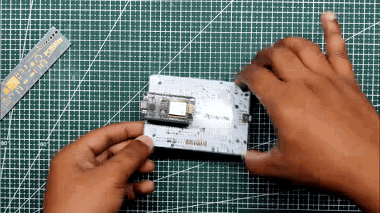

Step 8: CONNECTING IO Pins With RELAY MODULE
  • Next, we use the silver copper wire to connect each IO Pin of the ESP8266 Board with the IO Pins of the NODEMCU Board.
  • We add the copper wire near the GPIO Pin and then solder it in its place, next we add another copper wire at the end of the previous copper wire and make the connection with the Relay Module's IO Pin.
  • We do this for all GPIOs
  • For a few connections, we add wires.
Step 9: FINAL ASSEMBLY
  • After finishing the soldering job, we add the PCB Breadboard with RELAY MODULE, the board is now completed and we can move forward with adding the main code to it.
Step 10: WEB APP and Its Main CODE
This is the main WEB PAGE or WEB APP that is being used for controlling the Home automation setup, this web app is completely customized and is made completely from a single sketch without using any third-party tools.

Please note that this setup will only work if the ESP8266 and the device that you're browsing the APP on the same network. (LOCAL NETWORK OPERATION)
Step 11: RESULT
Here's the result and as you can see, this system is working.
There is an LED on top of each relay module that is turning ON and OFF whenever we toggle the relay via the WEB APP.
Step 12: Conclusion and Improvement
This Setup works and now we can add it in the MCB Box in our home to control a specific area or near any lighting switch that controls at least 6 light outputs.
The way it works is also simple, relays are like physical switches, and we can add them in series with any light source or output. By changing the state of RELAY to HIGH or LOW, it can break or connect the circuit and control the load connected to it.
This Setup uses a NodeMCU Board with an external 5V Supply.
Ideally, there should be a 240V AC to 5V 1A DC Converter onboard along with an easy load output connection with a single wire. NodeMCU can be replaced with a Minimal ESP12F Based setup that will have its own RELAY MODULE BOARD implemented in the same topology. This is what I will be doing in Version 2 of this project.
