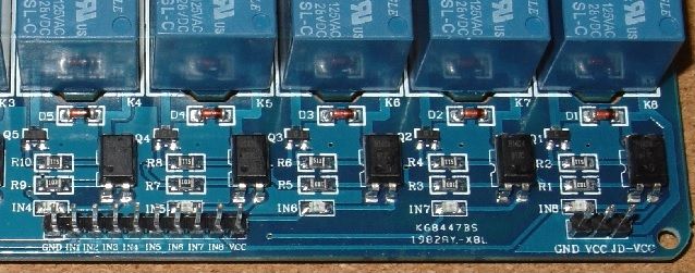

Step 5: Separate Multi-relay 5V and 12V Modules, High Triggered and Low Triggered
Separate multi-relay 5V and 12V modules, high triggered and low triggered
If you want more the 4 relays then there are a number of multi-relay modules available. Typically with 8 relays but some with 16 relays. SainSmart has an 8 channel module.
The specification for the SainSmart say each channel needs 15mA to 20mA to drive it. I expect this is an error as all the modules I have measured need <5mA to drive them. However I suggest you measure the actual current needed to drive the inputs of any 8 channel board you use. The Arduino microprocessor has an absolute maximum total digital output current of 200mA, so 8 times 20mA = 160mA is higher then I would like to run continuously.
Since both the Arduino drive voltage and the relay coil voltage is the same, +5V, there is no problem with low triggered inputs since the voltage from the relay board being pulled down by the digital output will not be more the 5V. But as will discussed below this is not the case for 12V relay modules. It is also not the case if you are driving a 5V relay module from a 3.3V Arduino board like the Due or Fio or SparkFun's FioV3.
Separate multi-relay 12V modules, high triggered and low triggered
It is sometimes more convenient to use 12V relays driven by a 5V Ardunio board. You may have a 12V battery supply or need to use 12V for some other part of the circuit, or the lower current used by the 12V relay coils may be a consideration. In these cases you have to be careful about how the 12V relay coil is driven by the 5V Arduino output.
As mentioned above a lot of the relay modules available do not come with circuit diagrams. Problems can occur if the relay module is low triggered. That is the relay control input is pulled to GND by the Arduino digital output pin. In that case, then when the Arduino output pin is high there may be 12V applied to it from the relay module. This may damage the Arduino microprocessor.
This is also an issue if you are driving 5V relay module from a 3.3V Arduino board like the Due or Fio or SparkFun's FioV3. Again the +5V from the relay board applied to the 3.3V digital output pin may damage the microprocessor.
There are two ways to avoid this problem.
i) Use a module that is high triggered by +5V. In this case there will not be any excess voltage coming back from the module when the Arduino output is low.
ii) Use an optically isolated module that has a separate trigger supply terminal in addition to the 12V supply terminals for the relay coils. In this case the Arduino +5V supply goes to the trigger supply terminal and no excess voltage will be applied to the digital outputs.
Above is an indicative circuit of one channel of 8 channel relay module (This circuit from SainSmart)
As you can see with an optical isolator and a separate Vcc input (+5V from Arduino) and the Arduino digital inputs are isolated from the 12V relay voltage by the optical isolator.
Also shown is a typical optical isolated 12V 8 channel relay board. Notice the Gnd and VCC near the IN terminals. That VCC is for the 5V supply from Arduino. At the right hand end is the JD-VCC pin which is for the 12V for the relay coils.
The photo above shows an example connection for 12V optically isolated relay. Note that the Arduino is being powered by 12V via the plug in power. The Vin socket on the Arduino is the same voltage as the power plug, i.e. 12V, so the relay module JD-Vcc is connect to Arduino Vin to supply the 12V for the relay coils. The Arduino Vcc is 5V and is connected to the relay module Vcc to set the trigger voltage. The trigger GND is connected to Arduino GND and D4 is connected to IN1 to drive relay 1. In this module the JD-Vcc and the Vcc connections both have the same GND point so only one ground connection is needed and no jumper is needed.

What most people are failing to realize is with the optical isolated multi relay boards all the opto's high side are tied together through the 5 volt coming from the Arduino board. this means you have to connect the low side pins on the relay board to the output pins on the Arduino and set that pin to low to make the relay turn on, when the pin is high the relay will be off. if you do not declare this in your sketch setup the relay will be on from the start up because the pins are automatically set to low and your project will not function properly.
Setup ()
digitalWrite(RELAY1, HIGH); // This will Turn Relay 1 Off so when the loop starts your relay will be off......if not they will all be on.

Hello, i have i more question.
If i would use 5V 16 Channel relay board and switch it from Arduino:
1. use external power for 16xRelay board - Can i switch with Arduino all 16 Relays at once? does it still apply the 200mA limit?
2. if 200mA is applied ,do i need to switch it via some kind of power tunner?
This is the board
Reply 7 years ago
For that many relays I would use an external 5V supply to power the coils.
It is a bit hard to see what the circuit on the board is, but I assume there is at least a transistor driver to switch the relays.
I suggest you use a multimeter to measure the current needed to switch one relay and work out from there how hard you will be stressing the Adruino chip. I would keep the the total to 100mA or less, myself.
Reply 6 years ago
These relays draw only 40milli-amps @ 5V. But it is always a good idea to make it a habit of placing an ammeter between source and load. Also, most of these relays are switched on via an optocoupler, so no need for flyback diode protection. see my video: Control 8 relays, plus 2 servos, completely independently AND simultaneously with a $3.00 ARDUINO 'Nano' and a simple sketch based on Object Oriented Programming and State Machines methods,https://youtu.be/xOqstsdmj54
Reply 7 years ago
Need to wait till it arrives, then i can test, but the Relays are SRD-05VDC-SL-C, as i test it on the 8x relay board it was 33mA/relay
1. so if i want to use all 16 Relays at once, does the EXTERNAL 5V power supply to the Realy board makes any difference/help for Arduino board?
2. if not how to drive all of them at once?
Thanks
Reply 7 years ago
Did you measure the current from Arduino digital output to drive the relay IN? Should only be a 1 or 2mA.
16 relays at 33mA each coil is about 530mA, This greater than the 500mA USB ports normally provide but you could use a USB Wall adapter instead, say a 1A or 2A one, and power the Arduino from it and then use the 5V Arduino output to power the relays. Note: do not use the 7V to 12V Arduino input to power the board and relays as the onboard Arduino 5V regulator is not designed to handle this much current.
If you want to program the Arduino while the relays are being driven then use a powered USB hub to supply the power and to protect your computer's USB port from power overload.
The Arduino has a 1A resetting fuse in the 5V line but you should be OK at 530mA + some trigger drive current per relay.
Finally if you are using an UNO you will need to use some of the A0 to A5 pins to drive the relays. You can control the A0 to A5 as outputs by referencing them as Pins 14 to 19 in your code
