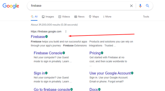

Open your browser, Search google firebase.
Click on their website.

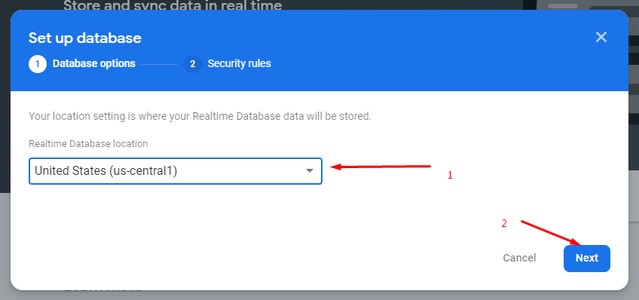

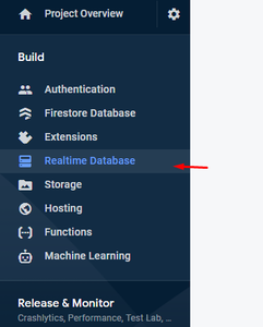

After create you a new project go to Realtime data base.
Then create a Realtime data base.
Copy your URL in database project and save it somewhere. We need that URL later.
