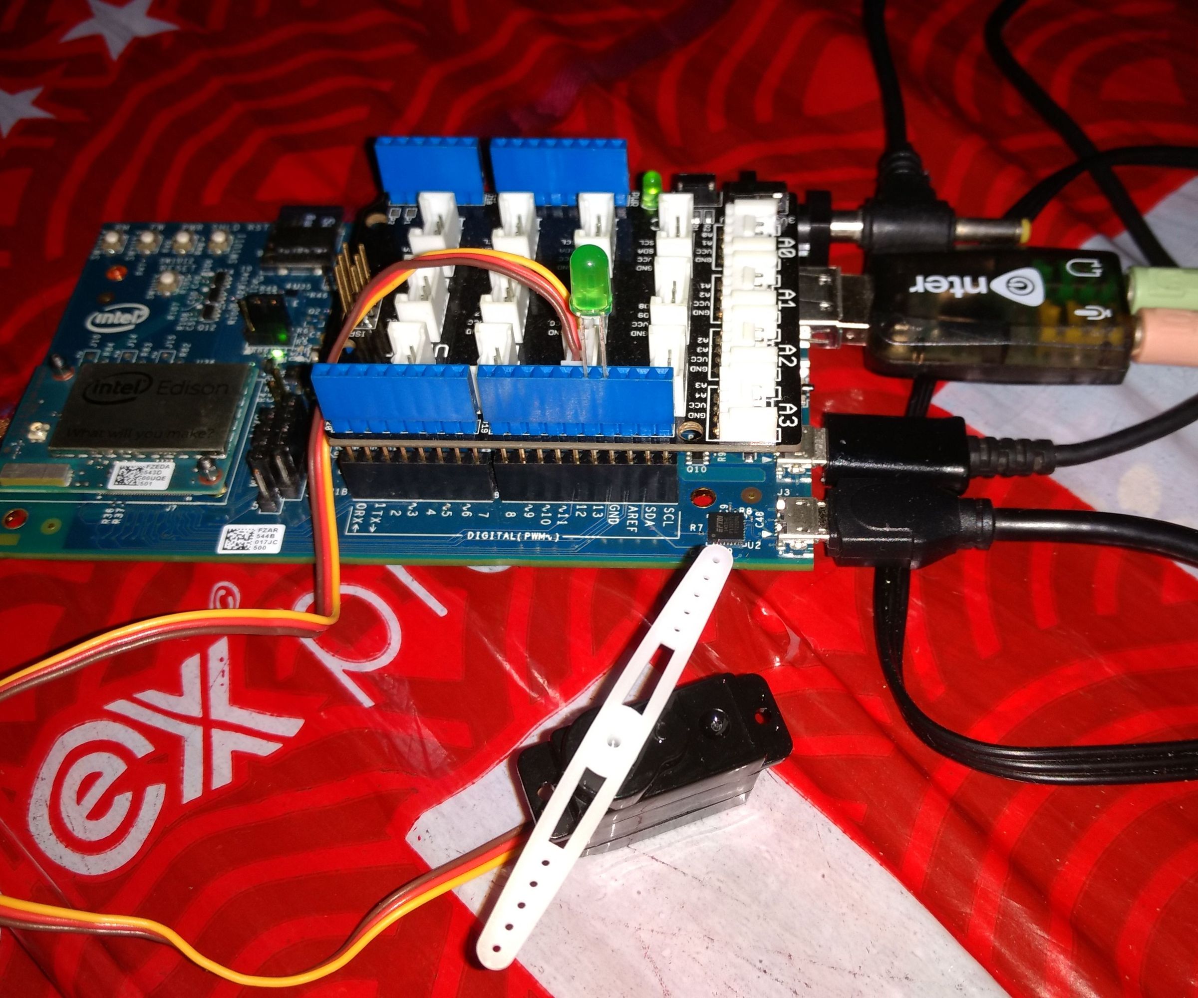

This article will guide you through the process of hooking up your Intel Edison with Windows Azure, and how to do some cool stuff, such as controlling it. This example will just switch on and off an LED or a Grove Relay connected to any of the digital pins on the Edison board paired up with the Arduino breakout board. Let's see how it really works. An Azure mobile service will act as a bridge between the Edison and the controller (a Windows phone app is used here). The Edison will read the value of an attribute from the table of the mobile service. A Windows phone app will update the value in the table, and thus we will make changes in the Edison code depending on the value.

After updating your errors will be resolved. After you compile the code, burn it into your Edison and then you are done. When the code is burnt in your Edison, take a LED, and attach the longer leg of the LED to PIN13 and the shorter leg to Gnd. An optional 233 ohm resistor can be added with the longer leg. Thus, our Windows Phone controlled Edison via Windows Azure is ready.
Another option specifically for home automation is to use the Grove relay and connect it to the digital pin. The electrical load will be connected to the relay. In that way the electrical load can be controlled.
