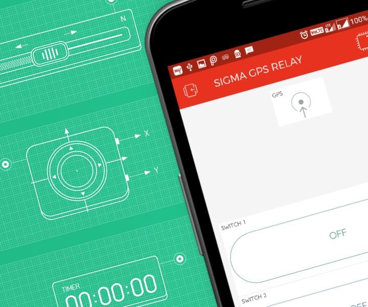

Step 6: The Blynk App
For blynk, the problem I was facing that I had to manually input the wifi SSID, wifi password and the auth token into the code itself and with a simple hack you can solve this issue. This hack was actually provided by one of the co-founders of blynk itself so you don’t need to feel guilty.
If you haven’t already, download the Blynk App from the Google Play store. Then open it, create an account and log in.
Or, if you already have the Blynk app installed on your phone, make sure it’s updated to the latest release!(P.S. It is both available for android and IOS).
Now, Open the app and create a new blynk account with your google account or facebook(I personally prefer Facebook, it is a lot more easier!).Click the QR-code icon in the top-right corner of the Blynk app (or the bigger icon on the main screen).and scan the QR code given in the images.(follow the screenshots ) That’s it you have done with the app setup too. Now, it's time to test the project.
Step 7: Testing
First turn the hardware on and make sure all the connections are correct. Now open the blynk project and follow the screen shot to set up your hardware to your wifi network.
After you have setup your hardware, click the play button
the top right corner to start the project.
Now, You can control your appliances from anywhere in the world.
