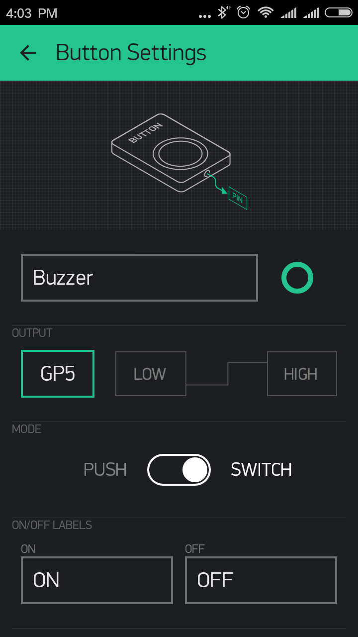

Step 5: Setting Up Widgets in Blynk App
So in this step we are going to build an awesoem GUI with Widgets provided by Blynk and we are going to setup all the virtual pins so that our project is ready to be controlled by phone. Excited!!!
For More basics into getting started with Blynk from scratch and configuring the Esp board in Arduino IDE visit my
instructable:
https://www.instructables.com/id/Simple-Led-Control-With-Blynk-and-NodeMCU-Esp8266-/
I highly recommend to visit my above instructables to those who are a novice , when it comes to working with Blynk .
So the once you are familiar with how to add and configure Widget, on the Blynk App, then it is only a cakewalk to build this project.
So assuming that you guys know how add widgets in Blynk, Just refer to the Screenshots. It contains all the images which are required to build this project.
