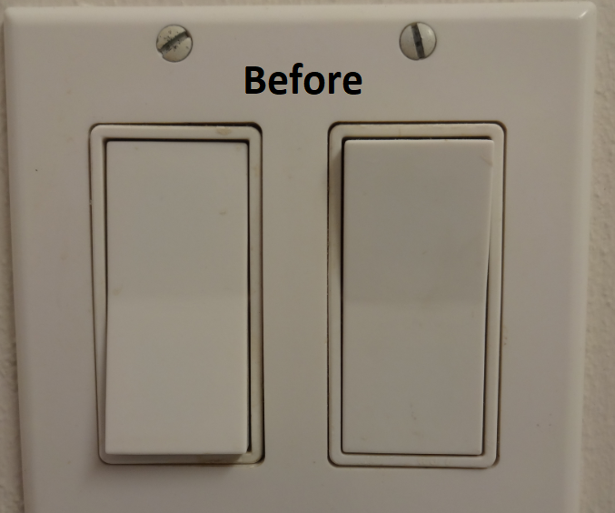

Step 6: Making the Box and Power Adapter
So lets get the following for your project. Please feel free to google for the bargains as the prices are not the same every where. I mainly added the link to the place you can buy it strictly for the information on the item itself. you are not obligated and encouraged to google for the best prices. (Of Course you knew that).
- Here is the link to my tinkercad.com page if you want to print a box for the whole thing:
Box for the relay module and power supply
- Blank single gang switch plate. You will need to drill a hole at the very center of it big enough for the push button switch.
1 Gang Blank Adapter
- Step Down Module 120v/250v AC to 5v DC
step-down power module
- Push botton with LED light.
push button with light
Step 7: Now Lets Connect Them All Together
- Connect output of the 125/5v dc module to Relay Module DC contact terminals
Please note the Positive and negative on the Step-Down Module and on the Relay Module
- Connect the + and - of the push button to the Step-Down Module
- Connect on side of the momentary push button to GND, Negative
- Connect the other side of the Bush button to GPIO2 on the back of the ESP-01.
I used a small soldering iron and made that connections. See above picture for the location of the GPIO2
The red arrow shoes the GPIO2 port.
- Solder two wires for the input power to the DC adapter module.
- Add two pieces of electrical wires to the NO and CO of the relay Module
- Pack all the pieces into the printed box using the pictures provided.
