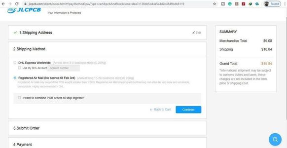

Step 7: Order the PCB
After downloading the Garber file you can easily order the PCB
1. Visit https://jlcpcb.com/ and Sign in / Sign up.
2. Click on the QUOTE NOW button.
3. Click on the "Add Gerber file" button. Then browse and select the Gerber file you have downloaded.
Step 8: Uploading the Gerber File and Set the Parameters
4. Set the required parameter like Quantity, PCB masking color, etc
5. After selecting all the Parameters for PCB click on SAVE TO CART button.

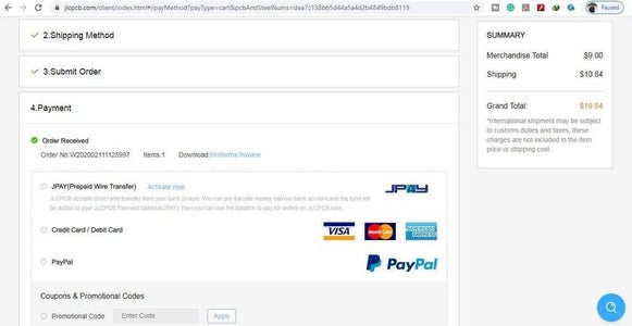

Step 9: Select Shipping Address and Payment Mode
6. Type the Shipping Address.
7. Select the Shipping Method suitable for you.
8. Submit the order and proceed with the payment. You can also track your order from JLCPCB.com.
My PCBs took 2 days to get manufactured and arrived within a week using the DHL delivery option.
PCBs were well packed and the quality was really good at this affordable price.

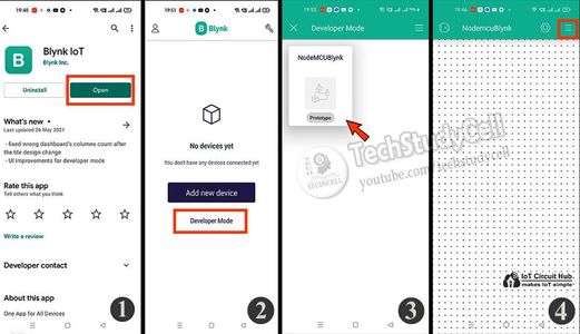

Step 15: Install Blynk IoT App to Configure Mobile Dashboard
  1. Install the Blynk IoT app from Google Play Store or App Store. Then log in.
  2. Go to Developer Mode.
  3. Tap on the template that you have already made.
  4. Now go to the Widget box (on the right) to add widgets.

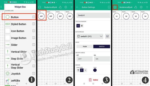

Step 16: Add Widgets in Blynk IoT App
  1. Add 8 Button widgets from Widget Box.
  2. Go to Button widget settings.
  3. Enter the name, select Datastream, Mode will be Switch. Then exit.
  4. After setting all the Buttons tap on exit.
