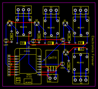

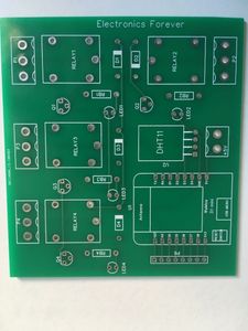

Step 3: Create the Circuit!
for this project, I have already designed the PCB layout using Easy EDA online software.You can check out PCB layout here.&Feel free to modify this layout according to your needs.
I got 10 PCB's from JLC PCB only for 2$.They provide very high-quality PCB's at very low rates.
Download Gerber file.
Goto JLC PCB add the Gerber File & then place the order for PCB's
