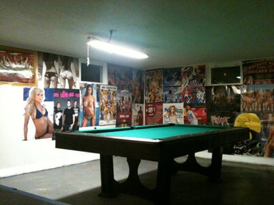

Existing Condition: Concrete Floor, Vinyl Panel Walls, Spray Ceiling (Finished Basement). *This can be seen in the photo with the pool table and posters.
Goal: Man Cave getaway: Full Bar, Pool Table, and Bathroom.
