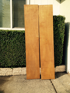

Sorry for the aside. Anyway, I had two sheets of nice plywood with a only few screw holes and a notch or two that went into my wood pile. Another trip to the Restore and we added a large bi-fold door, some 2x4s and some trim pieces. Once we removed the hardware from the bi-fold door, we had both a work surface and bar top for our new bar.

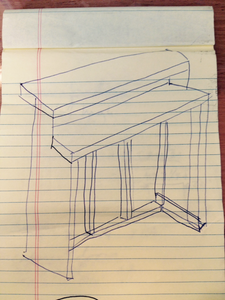

Ok, I don't draw that well, but I sketched out what the finished bar should look like from a construction perspective. Then, I measured the materials on hand, the space we had, and the low glass shelf/entertainment center that we planned to use as storage under the bar. Floor space is always a concern; using the entertainment center as storage under the bar solved two problems at once.
The length of the bar was determined by a compromise between the height (length) of the bi-fold doors and the length of the entertainment center. Other considerations: (1) The completed depth should be approximately 24", the standard depth for lower cabinets. (2) The bi-fold doors were about 13.5" wide. (3) We needed at least a 9" overhang on the bar top.

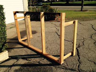

I have to admit that the design process was a bit fluid because that's the way I roll. By the time the frame was assembled, it was necessary to take some measurements in order to cut out the plywood for the two ends. This was partly due to the fact that both ends should pretty much be the same dimensions, and that the design still had a bit of fluidity about it that needed to be ironed out.
We only have basic hand tools, a sabre saw and an electric drill. Toward the end of the process, I was also forced to replace my defunct table saw in order to quickly add a 10 degree bevel on the top/wide edge of the 2x4s used to surround the bar top.
Step 3: The Build
The frame was constructed of 2x4s from the Restore and some 1x4 I had laying around. Reclaimed plywood, that was luckily furniture grade, was used for the front and sides.

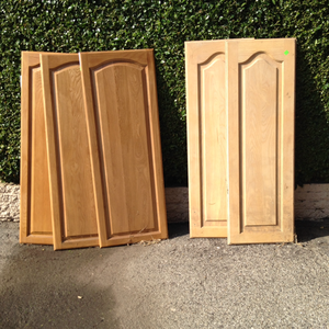

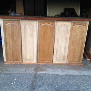

We filled the screw holes, then attached the cabinet doors to the front of the bar. The cabinet doors serve no practical purpose; they are purely for decoration. As you can see there were two different styles of door fronts, so we simply alternated them. The doors were slightly different heights, so we aligned the doors 1" from the bottom of the bar. The top of the cabinet doors are staggered to "showcase" the differences in the top arch.

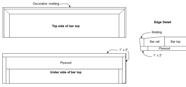

One half of the bi-fold door was attached to the bar using cleats to form the work area surface. The other half of the bi-fold door was used for the bar top. The 2x4s that had been beveled on the table saw were used to wrap three sides of the bar top, mitering the corners of the 2x4s. We added some additional plywood, molding, etc. to the bar top, then we used shelf brackets and L-brackets to attach it to the bar.

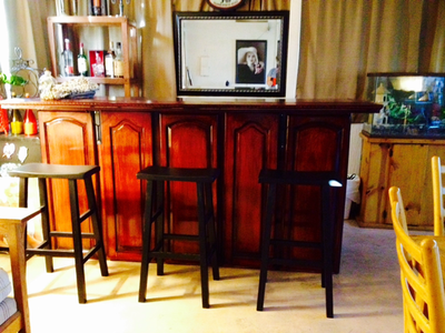

Step 4: The Completed Project
We used several coats of water-based Varathane Stain + Poly in "Cabernet" on all of the exterior surfaces. Since the cabinet doors were different species of wood, we used additional coats on the lighter wood. When that had dried for a couple of days, we added a coat of "Ebony" to tone down the red and give an overall warm glow. Before that dried, we wiped off some of the dark stain to enhance the look. We plan to protect the bar top and work surface with a wood finish that protects from alcohol stains. We also painted the interior surfaces under the bar with flat black spray paint.
The project was not cheap, but the outcome was superb. Here is a breakdown of the cost:
