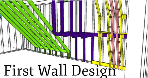

My garage back wall is 24' wide so I could make 3 separate sections each 8' wide. You can see the design in our next segment "design."
Step 2: Design
There are many ways to design your wall, I did a few of them but the best idea is to find out what will work best for you, and importantly have fun! Does your wall really need a crazy triangular protrusion at 65°? No, probably not. But maybe that rough sketch turns into something cool that you really like. My advice though is keep it simple, not only is keeping it simple easier to build, but it's also much easier to set problems on so you don’t keep resetting the same problem everytime you reset your wall. You can always use any leftover plywood sheets to make volumes (my next upcoming Instructable) to add some needed variety to your wall. My first few designs had everything, a 90 overhang, a crack, a weird triangular 35° section meeting in a 45° and a 25° but when it came to building that I would have had a lot of troubles and probably would have needed to hire a professional to just cut some of the angles.
I settled on (from left to right when facing the wall) a flat left wall, for friends kiddos (and some ridiculous crimpers I picked up), a 35°, a glorious 12 ft 45° in the middle, and a 25°. The 35° and the 45° were set up to include a 1ft kicker with the 25 having a 2 ft kicker. You can see my first design attempts and second design attempts (more grounded in reality) in the images. The drawings were made using google's sketchup 2016 which is free (for personal use) and a lot of fun to just mess around with.
Relative terms I will used throughout this Instructable:
Supports- boards which I attached to the walls or ceilings to allow for proper spacing of the framing and to attach the framing to the wall without having to attach the framing directly to the studs of the garage. The supports are connected through the wall to the studs of the garage. My supports were 2x12’s attached directly to the studs though the existing wall.
Framing- the actual frame of the bouldering wall, which the plywood will attach to. The framing makes the general outline of the wall and the plywood makes the climbable surface. The framing includes the 2x6’s attached to the supports through the joist hangers, and the 2x2 furring strips are attached directly to the studs through the existing wall.
Existing wall/back wall- the existing wall is what I’m attaching the bouldering wall supports to for building the wall. My existing walls was already insulated between the joists and sheathed with ¼” OSB, which I left attached to the wall for insulation and just screwed though for the supports.

Step 5: Setting Up the Supports
The supports are attached directly to the wall, the framing is then attached to the supports placing the load of the wall and the climber on the supports which are fastened to the joists of the garage. Its best to mention here that if your garage is not insulated or does not currently have an interior wall, you can attach the framing directly to the studs by screwing the framing to the studs with the framing placed on the left or right side of the studs of the wall. This method of attaching the framing to the studs is easier and requires less complicated cuts and less materials so it can be done quicker and cheaper, but if you live in the frozen north, you may need to maintain your insulation in your house or garage, ergo supports.
The supports can be screwed directly to the stud or through the wall into the stud. Pro tip, studs are typically 16” on center, so that means if you know where one stud is, you can measure 16” to the right or left to find the next stud, be careful though if you are on the edge of the stud you may accidentally drill through the side of the stud reducing the structural integrity of your support (measure twice, drill once) if you miss the stud, remove the screw and try again. The first thing I did was mark all of my studs on my wall sheathing.
To attach the wall supports I determined how high I wanted my kickers. With a 1 ft kicker on the 35°, 45°, and flat wall and a 2 ft kicker on the 25° wall, I placed my wall supports 11" off the ground for the 35°, 45° and flat wall and 22"off the ground for the 25° wall. The wall support was then fastened to the joists using he 3-⅛” T25 Torx screws by screwing through the 2x12x8’ into my wall sheathing, then into the joists.
To attach the ceiling supports a few measurements and angles must be used to determine how far the ceiling joists need to be placed from the back wall. A right triangle can be used to calculate the distance using the angle (this is why I used 2x12’s instead of 2x8’s not only are they more structurally secure but they allow for a little more wiggle room if you place the ceiling support a few inches too close or far away from the wall). There are a few websites out there to figure out your distances and cutting angles using a simple triangle, I used http://www.calculator.net/triangle-calculator.html, pretty simple to use and gives angles and side lengths.
I placed the ceiling supports such that the center of the 90° rafter joist will fall in the middle of the ceiling support based on the preferred angle of the wall. This can be measured in both sketchup in your drawing using the measurement tool and before mounting to double check you have the correct distances.
Since my rafters would run parallel to my roof supports. I had to add additional supports running perpendicular to the rafters and the roof supports. These supports are perpendicular to the roof supports (support supports?) allowed for a more precise positioning of the roof supports without having to attach the frame to the roof rafters, and will allow the possibility of the addition of a roof section. The perpendicular supports utilized 5 ft of 2x6 boards with three for both the 35° and 25° sections and 4 for the 45° section. The reason why they are 5 ft long is because wanted them to be able to attach to at least 3 rafter joists, which again if you remember are 16” on center resulting in a 4 ft section being the minimum length, the extra foot is just there for reasons I do not have an answer to. For the ceiling supports I used a 2x12x10’ board in the center for the 45° section (for when I want to later add a roof) and a 2x12x8’ for each ceiling support for the 25° and 35° sections.

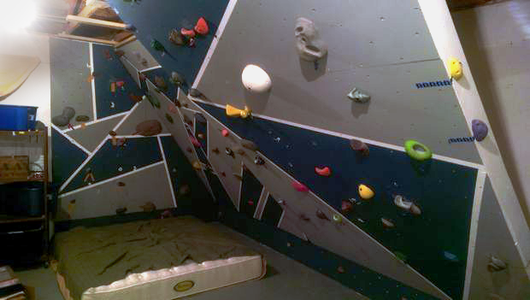

Step 9: First Climb
Obligatory final wall and first set problem pictures.

Step 11: Final Wall
Here are some pictures of the final wall. I hope that this Instructable helps inspire you in your climbing wall construction endeavors.
We purchased holds from our old climbing gym before we moved and also got some seconds from Escape climbing company http://www.escapeclimbing.com/climbingholds/ as well as all of our hardware for fastening the holds to the T-nuts.
For padding we found a few used mattresses on craigslist and sew a few slip covers to protect the mattresses from unneeded wear.
Remember climbing is inherently dangerous. It is best to remind your friends and practice safe falling and how to spot each other correctly.
