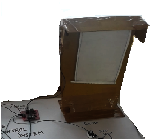

Step 4: Curtains
Opening and closing of curtain make a person tired. As if are sitting far from curtain and we want to open/close the curtain, then it will be boring working to stand up go there and open/close curtain. So automatic curtain allows the person to control the curtain from far by remote button or mobile.
If you want to make a Extra Cart board arrange for it as shown in Picture, but if you want to apply it for real curtain than you just need to Connect the shaft of the Curtain directly with the DC motor for Rotation.
Connect the Terminals of the DC Motor to the Output pins of the Motor driver or to the output pins of the Relay Module.
Connect the Input pins of the Motor driver Module to the Digital pins 7 & 8 of Arduino Board.
For More information on this Refer to my previous Instructable Remote Controlled Curtain !
