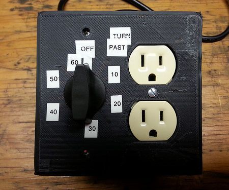

Step 7: Assemble Everything and Install
Now that all the pieces are ready, the final step is to assemble all the parts and install the HESA.
Schematic
The schematic diagram for the water detection circuit and all the pieces is here.

Duplex power outlet
Take an unused power cable and cut both ends off. Then, cut a ten inch length off of the cable. Strip about an inch of the casing off of each end. Strip 1/4" of the casing off of the wires on one end and 1/8" of the casing off of the wires on the other end. Connect the 1/4" long copper side to the duplex power outlet.
Next, attach the duplex power outlet to the enclosure with screws and nuts.

Mount the enclosure on the wall
Use a hammer drill to drill two holes in the wall for the screws. Ideally, the screws will have heads that fit through the larger hole on the enclosure but will not fit through the smaller hole at the top of the opening. Insert the screws into the wall most of the length of the screw. Hang the enclosure on the screws. Tighten the screws so the enclosure does not move.
Attach the acrylic to the front of the enclosure.
Connect external connections
Once the enclosure is on the wall, plug a power cord from a 120v outlet to the power input plug. Plug another power cord from the duplex outlet to the water softener. Plug a nightlight into the other outlet on the duplex outlet. Plug an ethernet connection from the local area network into the network jack. Finally, plug the leads from the water detection cord to the circuit connectors. Run the other end of the cord to the crock in the floor.
Power Up and Test
That's pretty much it. Flip the power on and give the Pi a few minutes to boot up. The nightlight should turn on when the Pi runs the HESA program.
If you installed Avahi and got the Apache web server running, you can bring up the web page that the HESA program creates when it runs.
