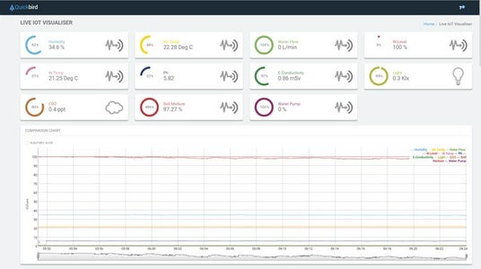

- When you're done click on the “Go to IoT Visualiser” button. This is what you will see. At the moment this is just some dummy data and your visualiser is waiting for you to send it some data… and this is what we’ll do next.

- Go to IoT Visualiser and you should see live data coming through from the Edison. If you don't see anything, refresh the page.

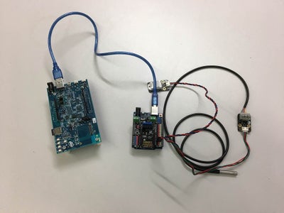

Communication
Arduino communicates with Intel Edison through the serial port. Using the large Arduino adapter board for Edison is probably the simplest way to connect them.
You can use the full size serial A port on Edison and Serial-B port on Arduino to connect the two with a normal USB cable. In that case, you only need to power the Edison, as it will supply up to 1A of 5V power to the Arduino – way more than most Arduino boards can source. In turn, the Arduino can’t power the Edison.

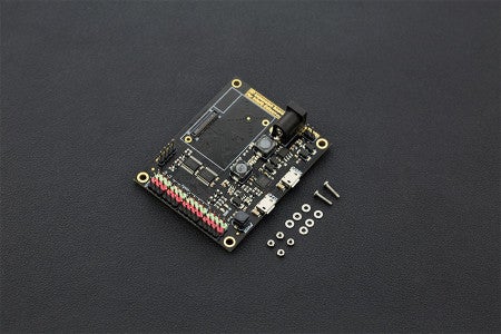

We prefer to use the hardware serial port on the Edison. There are two of them, and we use the first one. By default, our app sets all ports to a baud rate of 115200 bits/sec. For that we use this small adapter board from Dfrobot. It’s cheap, compact and includes the level-shifters from Edison’s annoying-but-power saving 1.8V to Arduino’s obsolete-but-trusty 5V. Unlike the large board, the Dfrobot one does not have any configurable logic or multiplexers that you have to deal with. We make a straight connection between power, ground, TX and RX pins on that board and the Arduino.
