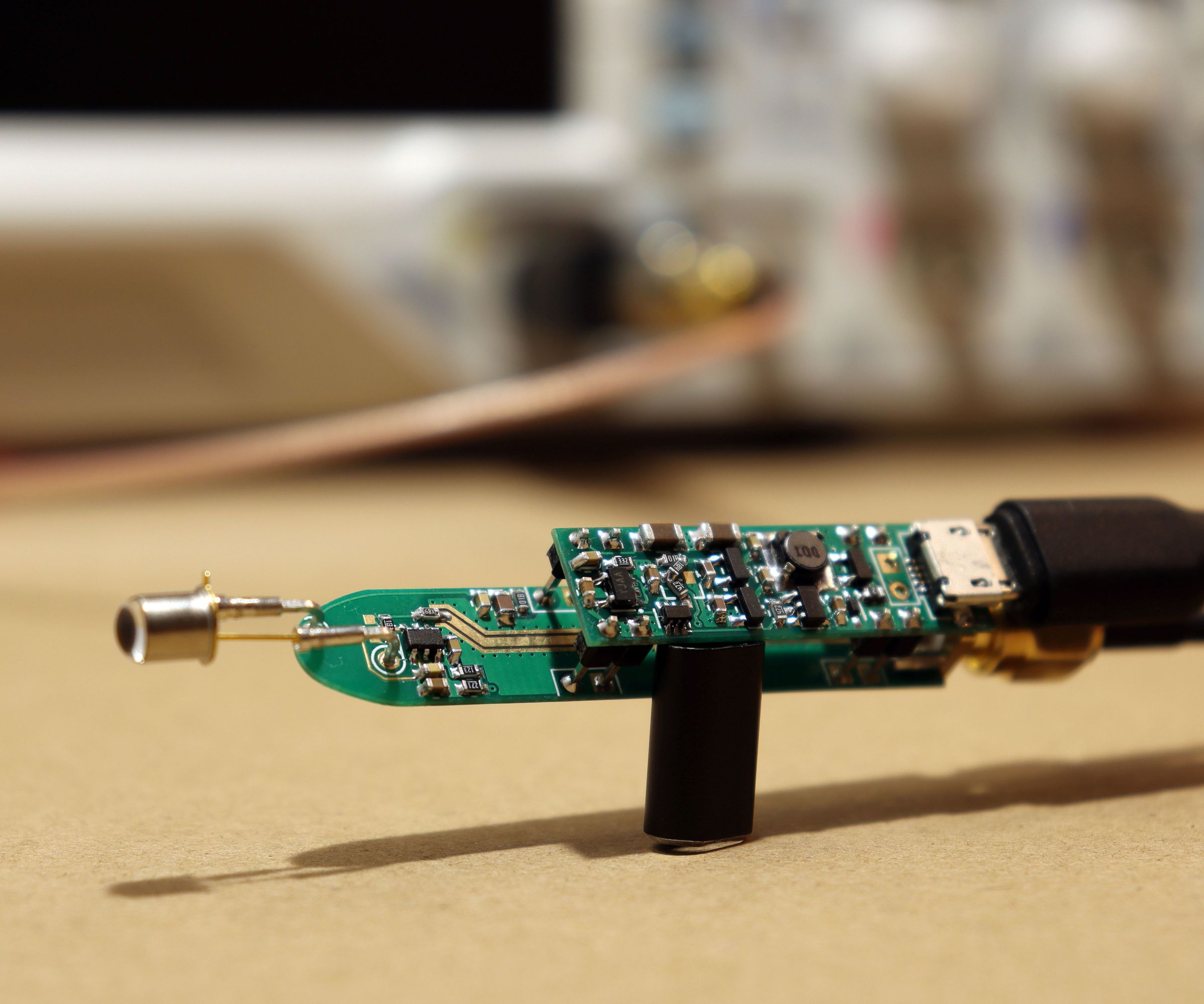

Introduction: Home Lab Voltage Reference Module
If you've ever worked with the ADC of an Arduino you've probably discovered that the readings aren't accurate at all. And it gets even worse about it's rated temperature range.
There are many reasons for this, but one of the main causes is within the way an ADC operates. It can not measure a voltage on its own, but only compare it with another voltage. The Arduino offers you to choose from an internal 1.1V, the AVCC system voltage as this reference voltage or an external voltage input.
Unfortunately the first two ans simple solutions are far from perfect. The internal reference has an initial accuracy of 10% and an unspecified behavior over the temperature range. The AVCC voltage heavily depends on the used regulator, the capacitors used, the board layout, other load on the same rail and much more.
The simple solution is to use a specific external reference IC to generate an precise voltage. This voltage can be feed into the AREF input of the Ardino or any other ADC/DAC for that matter. Those chips can be manufactured with incredible tight voltage tolerances of down to 0.02% and with a temperature drift down to 1ppm (0.0001% change per °C). With that spec they can be used to calibrate basically anything, from an Arduino to your multimeter!
As those chips can get fairly pricey I wanted to be able to re-use them for any future project and thus designed a small adapter board. While I was on it I added plenty of protection, additional smoothing and out-of-spec outputs.

Step 2: Assembly
Start by soldering wires into the top 14 holes of the socket. Be careful to not overheat the plastic as it may deform and badly fit into its socket.
Alternatively you can remove half of the large holes for the socket on the PCB to end up with "castellated vias" like in the picture above. You can either use sidecutters or a small handsaw for this job. Good PCB manufactures will do this for you, but the boards likely cost unreasonable more.
The second option is faster by may result in less durable solder joints after mounting.
This module is designed to suit multiple reference ICs. Depending on which chip (and output voltage) you choose, you need to pick the right value capacitors and resistors. Recommended values for common parts and configurations are provided in the spreadsheet as part of the → documentation. If you want to use an other reference you may want to check out the chapter → Customise.
After you figured out which values to use solder all components except the reference onto the PCB. I'd suggest to solder the fine-pitch TSSOP-14 part first since rework will be fairly easy then. Proceed with the remaining components.
The next step might be to test the module to check if everything (except the reference) is working correctly.
Now you can proceed to solder the PCB onto the socket as shown. The bottom section is designed to fit right between the plastic frame. Be sure to match the pin 1 indication (notch in the socket, square pad on the PCB).
The last step is to solder the main voltage reference onto the module. This should be done last not only because it is the most expensive part in this project, but to reduce thermal and mechanical stress as much as possible. The effects are tiny, but in comparison to the super tight tolerances it does have a rather significant influence.
