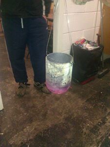

Step 1: Empty Gas Tank Clean Clean Clean
We attached our gas tank to a BBQ and burned off the last few minutes of gas tank.
Then put a regulator on hung it upside down and turned it on.
Drill small hole in top BE CAREFULL
Drill another hole in bottom
The tank will be quite full with gunk that smells really bad.
YOU MUST CLEAN BEFORE CUTTING.
To clean it out we then made these holes much bigger then put lots of boiling soapy water washing out threw the gas tank.

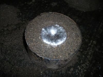

Step 5: Meliting Stuff
Took around 25 minutes to melt first block of aluminium and then took another 5 minutes per extra bock we added. we have break down of build under images below.
