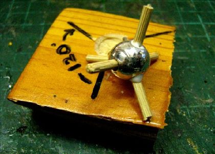

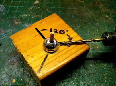

Step 1:

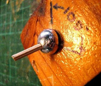

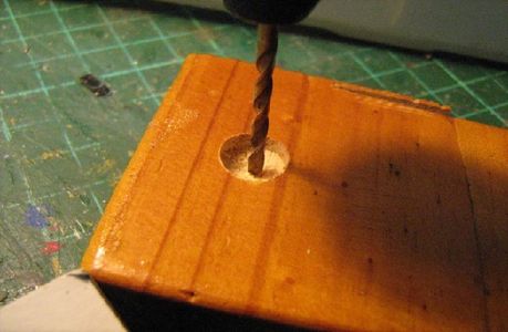

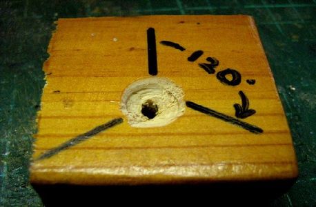

A hole 10 mm in diameter and 5 mm deep is drilled into a wooden block, and angles of 120 0 are marked off around the circumference of the hole . The edge of the hole is chamfered with a countersink or a sharp knife so that a 12 mm ball will sit snugly in the hole.
A 2.5 mm diameter hole is drilled vertically through the centre of the 10 mm hole.
Using the same drill, a hole is then drilled diametrically through the centre of a ball and a 27 mm length of bamboo skewer glued into this. The ball with its protruding prongs is now located by inserting one of the prongs into the hole in the jig

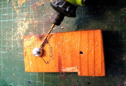

Step 2:
The three “equatorial” holes are then drilled into the ball following the 120 0angle marks. Three 12 mm lengths of bamboo skewer are glued into these holes to complete a trigonal bipyramid atom centre.
The octahedral jig is identical to this, except that four equatorial holes at 90 0are needed.

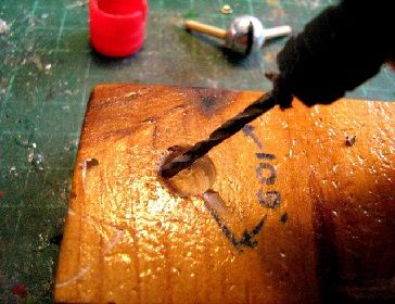

Step 3:

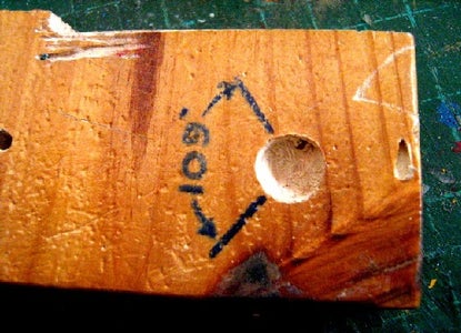

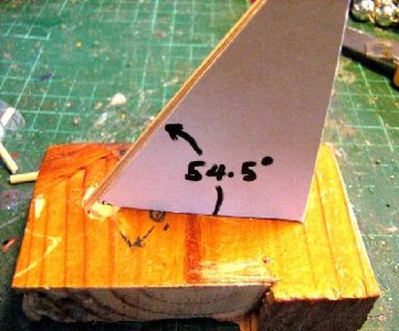

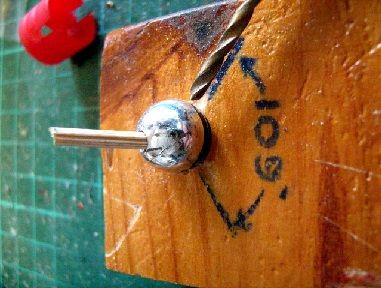

To make a tetrahedral jig, another hole 10 mm in diameter and 5 mm deep is drilled into a wooden block, and an angle of 109.5 0is marked off on the circumference of the hole. A 12 mm ball is then located in the hole and drilled with two holes at an angle of 109.5 0 as indicated by the marks.

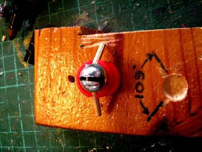

Two 12 mm lengths of bamboo skewer are glued into these holes. You will then need a cylindrical piece of plastic, such as the cap from a felt tip marker, in which has been cut two slots so that the prongs will slide into the slots. The atom centre is inserted with the prongs pointing vertically downwards and a marking pen is used to draw a line on the ball perpendicular to the plane of the two prongs.
The ball is then removed from the jig, and another hole is drilled into the block at an angle of 54.5 0from the horizontal , so that one of the two prongs on the atom centre can be inserted with the marker line level with the circumference of the 12 mm hole, having the two 109.5 0 marks exactly opposite the prongs.
Step 4:
The remaining two 109.5 0holes are now drilled in line with the marks , and two more 12 mm lengths of bamboo skewer glued into the holes. The result will be a tetrahedral atom centre having four bonds at angles of 109.5 0 These are used for sp3 hybridised atoms, such as the carbon atom in methane. Atom centres for sp3 nitrogen, oxygen and sulphur can be made on the same jig, but using only the required number of prongs. I prefer to leave the extra prongs in place to represent lone pairs of electrons (where applicable ).

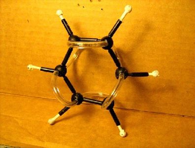

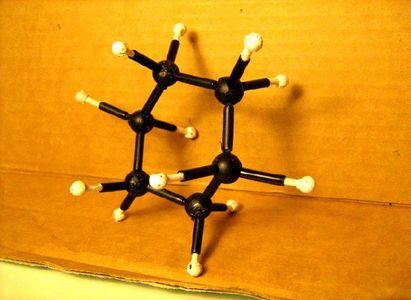

Example 1 : Cyclohexane( sigma bonds only )
Parts needed : 6 black tetrahedral atom centres ( carbon ), 12 white hydrogen atoms and 18 sigma bond tubes. Using the sigma bond tubes pushed over the atom prongs, join the 6 carbon atoms in a 6-membered ring in the chair conformation, and connect 2 hydrogens to the remaining prongs of each carbon atom. The model may be flexed to convert between different conformations of the ring.

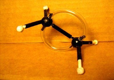

Example 2 : Ethylene( Double bond )
Parts needed : 2 trigonal bipyramid carbons, 4 hydrogens, 5 sigma bond tubes & 2 pi bond tubes
Connect the carbons and hydrogens in the sigma bonded framework, then attach the pi bonds to the axial prongs of the carbon atoms as shown.

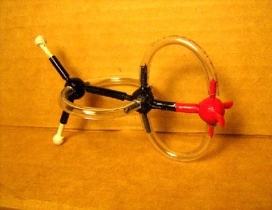

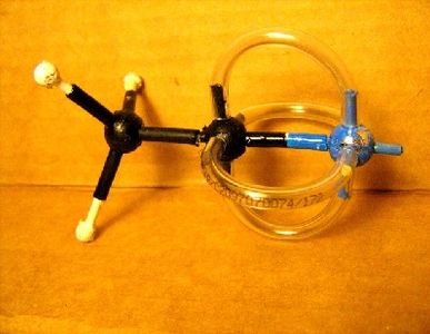

 Example 4 : Acetonitrile ( Cyanomethane )( Triple bonds )
Parts needed : 1 tetrahedral carbon, 1 octahedral carbon, 1 octahedral nitrogen, 3 hydrogens, 6 sigma bond tubes and 4 pi bond tubes.
Using the sigma bond tubes, form the linear structure C-C-N with the octahedral carbon in the centre, and attach 3 hydrogens to the tetrahedral carbon.. Attach the 4 pi bond tubes to the remaining prongs of the carbon atoms, and their other ends to the adjacent nitrogen atom prongs, forming four curved pi bonds as shown.

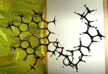

Step 10: Home Made Molecular Model Kit
Example 6 : Chlorophyll A ( Example of a large molecule built with this kit)
