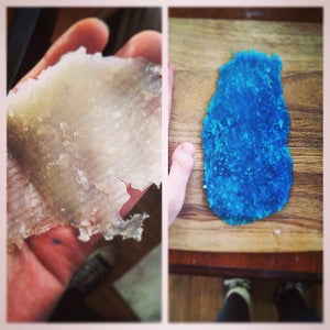

Bio-plastic Recipe
-1Tablespoon Cornstarch
-1Tablespoon Gelatine
-1Tablespoon Vinegar
-1Tablespoon Water
-Food coloring of choice
Instructions
Step 1- Combine all of the ingredients in a small saucepan.
Step 2- Place on the stove top set at medium heat.
Step 3- stir the mixture constantly until it turns from a liquid to a gel.
Step 4- Use a spatula to remove the hot gel from the saucepan and spread in onto parchment paper.
Step 5- Place it out of the way in a ventilated area to dry completely. (This step may take from 2 days to 2 weeks depending on how thick you spread the gel out onto the parchment paper.)
