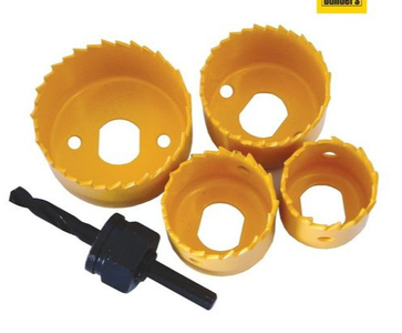

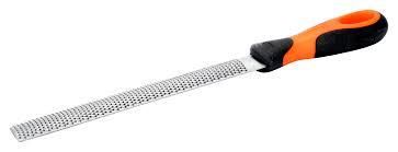

then you'll need the right tools to make it easier so you'll need a chisel, drill, 3 or 4 mm drill bits, circular saw drill bit, 100 grit and 500 grit sand paper and if you do not have access to a grinder you can use a rasp

So i edited the picture with orange stripes indicating that the grain of the wood is going vertically straight up from bottom to top. Now you need to attach the circular saw bit to the drill and drill straight down until it cant go any deeper that is going to shape the outside of the pipe bowl. Now you need to chisel around the out side of the cut but keep a bit of wood on the side as shown in the third picture because that is where you're stem will be shaped

now you need to make everything round by rasping or grinding. You also need to make the middle hole wider for you're tobacco and take a 3mm or 4 mm drill bit and drill a hole from the stem that leads to the deepest part of the middle hole
