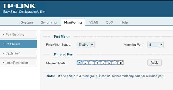

And im using Port 8 to mirror Port 1 of the switch.

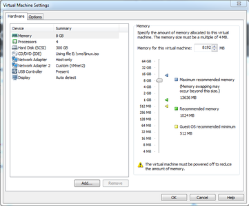

Step 3: How to Set Up the VMware Networking
In VMware Workstation 9 go to edit - Virtual Network Editor
The default contains three connections 1 bridged, 1 Host-only, and 1 NAT.
Click Add Network ( i did VMnet 2)
Set it to Bridged and select your second eth port for monitoring ( mine as and Intel port ).
Then click apply and OK.
Step 4: Setting Up Your Security Onion
I'm not going to go threw the full install of Security Onion on this instructable because there are plenty of other instructions out there. The image is the setting's that i used and make sure that you have created two Network adapters and that the second one is set to your new bridge VMnet that you created.
Step 5: Mirroring Port
TP-Link makes mirroring ports really simple.
The picture says it all.
