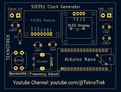

Begin by designing your PCB layout using a CAD or PCB design software. Popular options include KiCad, Eagle, or EasyEDA. Ensure your design includes all necessary traces, pads, and components. For single-sided PCBs, create two layers: one for the copper traces and another for the silkscreen (component labels). Export your design as a PDF or image file for printing.
Step 1: Print the PCB Masks

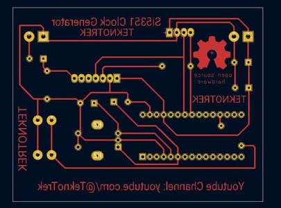

Print your PCB design onto glossy photo paper using a laser printer. The toner will act as the etching mask. Ensure the print is dark and dense, as this will improve the quality of the final board. For the copper layer, print the design as-is, but for the silkscreen, print a mirrored version. Adjust your printer settings to maximize toner density, and test a few prints to ensure clarity.

If you want to add component labels, repeat the toner transfer process on the opposite side of the board using the mirrored silkscreen design. Align the silkscreen with the copper traces by holding the board up to a light source. Iron and soak as before, leaving the toner in place as the final silkscreen layer.
