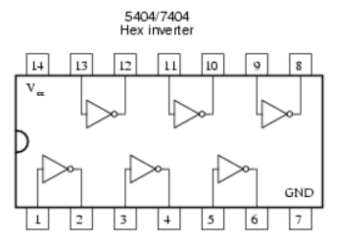

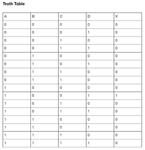

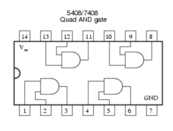

Our first set in starting this project is to get a password set up for the alarm system. In order to do this, we will use logic gates and a DIP switch. Firstly, we need to make a truth table for 4-inputs and set only one combination which will result in giving a high output, refer to the truth table above for an example. This combination for your alarm can be anything of your choice but it has to be one of the 16 combinations listed in the truth table above. After creating your truth table and selecting your desired password, you will need to do the Sum Of Products (SOP) to create a boolean equation. For people who don't know what the sum of products is, it is a recipe for creating a circuit that can produce an output for any given truth table. For any single output and any number of inputs, we can produce a circuit using this method. Please refer to this video if you do not know how to do the sum of products. Now that you have your boolean equation we can get to making the schematic now, for my boolean equation there are 3 AND gates and 2 NOT gates, you can calculate how many gates are in your boolean equation. We only need to use one AND chip (74HC08)and one NOT chip (74HC04) as it is more than sufficient. then to make your schematic you need to label 4 inputs (A, B, C, D) like in the picture above and run it through the gates in sequential order to get your output. Now we have made your 4-digit password for your alarm system, so using this schematic we just hook up the wires on Tinkercad or Personal Arduino. Please refer to the Tinkercad circuit image above for your reference and the logic chips schematics to wire the inputs and outputs correctly.

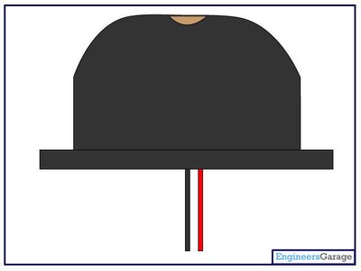

Step 4: Setting Up PIR Motion Sensor and Piezo
We are almost done creating our project, we now just need to wire in our PIR Motion Sensor and Piezo and write the code. I will attach a diagram of both the PIR and Piezo for your reference of the pins. First, we'll wire the PIR motion sensor to the Arduino. Take 2 wires and connect the power/VCC pin to the 5V power in the Arduino, and connect the GND to the ground on the Arduino. Finally, take another wire and connect the signal pin on the PIR to pin A1 on the Arduino. Now we'll move on to wiring the Piezo, this is very simple. Take 2 wires, connect the positive end (red) of the piezo to the Arduino pin A2 and take the other wire to connect the negative end (black) to the ground. Now you have successfully wired all the components of the circuit and you are ready to move onto the code.
