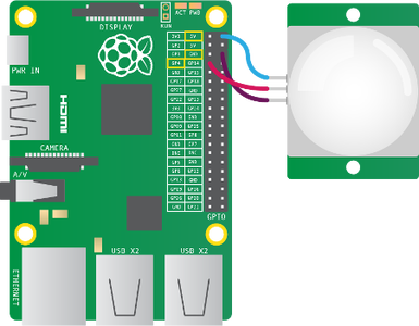

Now connect the USB camera and PIR sensor to the Raspberry Pi.
Using three female-to-female jumper cables, you'll need to connect each of the PIR sensor's connectors to the appropriate pins on the Raspberry Pi.
Connect the top one labelled VCC on the PIR sensor to the 5V pin on the Raspberry Pi, connect the middle one labelled OUT to GPIO pin 4, and connect the bottom one labelled GND to a ground pin also marked GND.

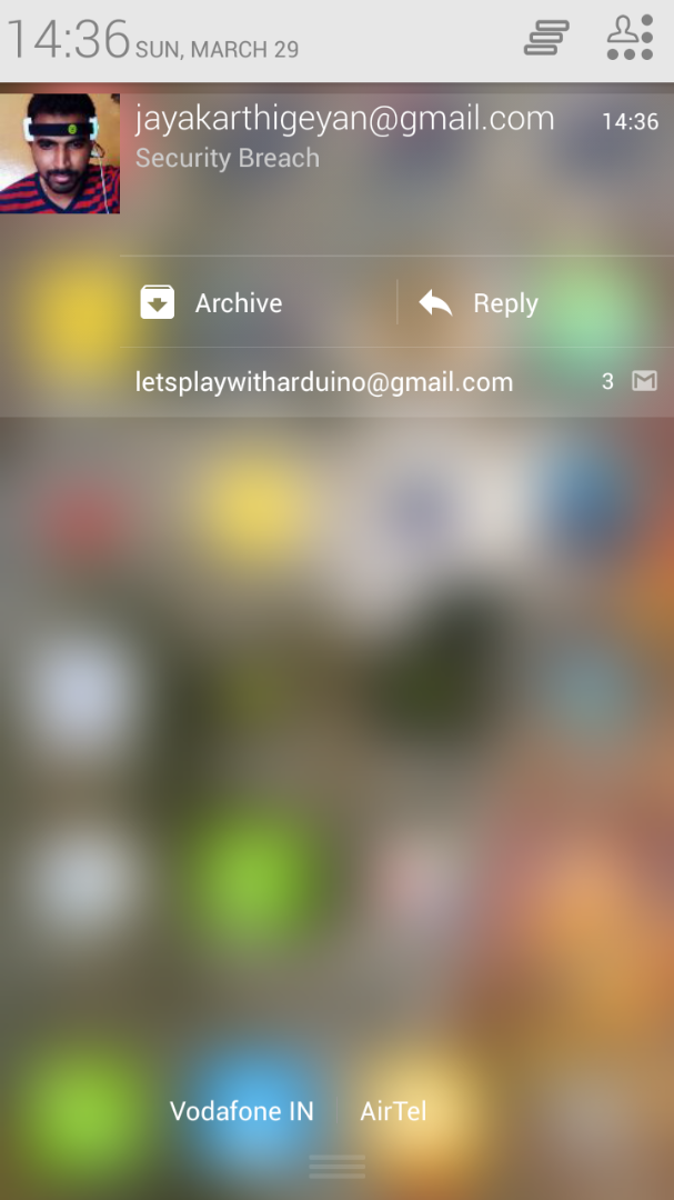

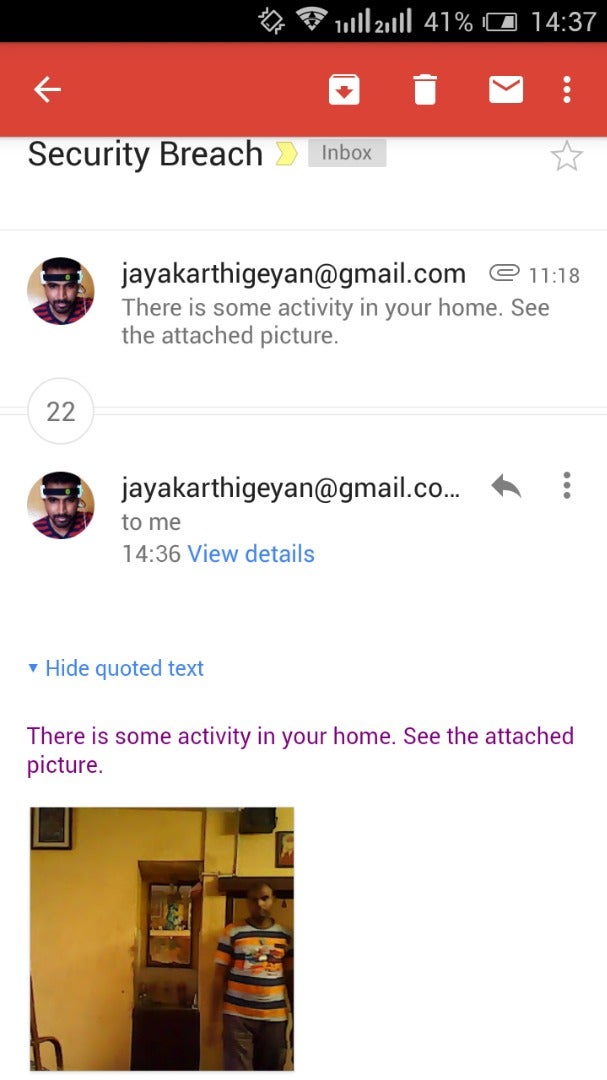

Now you run the python code with sudo to check the setup. Whenever there is a movement it detected by the PIR sensor, an image is captured and email is set the to email address you entered as the receivers email address.
Step 6: How the Final Setup Looks and Output
Now, if you put the setup infront of your home door and run your python code and leave your home. If someone opens the door, you will get an email alert.
