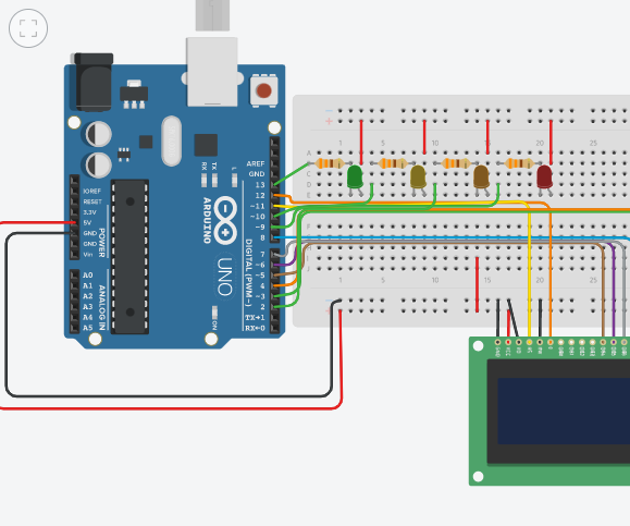

Step 1: Wiring the Project
This was the hardest part for me becuese there are so many wires due to the amount of parts that were used. So Before wiring everything I recomnd to give power to both power rails first then moving on to wiring the slide switches and the logic gates becuese by far that would be the hardest part to wire if you choose to do it last. The rest of it is easy you just got to make sure that the right pins go to the right arduinio port.
Trig pin (distance sensor) = 2
Echo pin (distance sensor) = 3
SCL pin (I2C LCD) = A5
SDA pin (I2C LCD) = A4
Red_Led (+) = 11
Green_Led (+) = 13
Yellow_Led (+) = 12
Buzzer (+) = 4
Slideswitch 5 (middle) = 10
