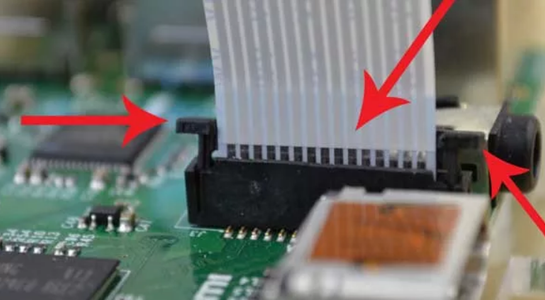

You’ll need a Raspberry Pi Camera and A regular IR camera. Once you got your camera, we will need to install the camera and to do this go to the ribbon slot which is directly behind the Ethernet port. using two fingers gently then pull up on both sides of the connector using two fingers. you can take help from the picture here. Once the connector is opened, you have to insert the ribbon cable with the metal leads facing away from the Ethernet port. keep it in line and gently press back down on the connector. The cable is now locked in place.

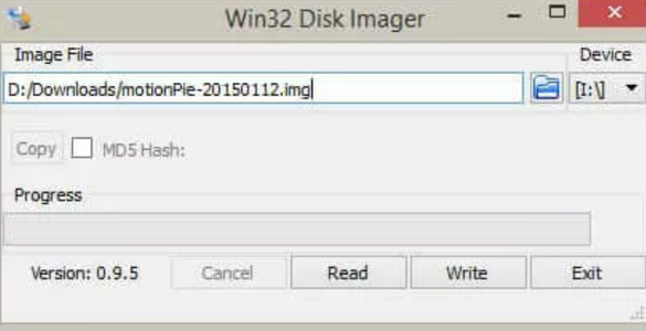

Step 1: Download Win32DiskImager.
Step 2: install the MotionEye OS image file onto the Pi.
Step 3: Select the MotionEye OS image file and the drive letter your SD card is assigned.
Step 4: Check if you have the correct details and click on Write.
Step 5: After completing all the steps you can safely remove your SD card from the computer.
