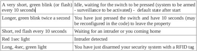

The very first run will start with the learning mode with green and red LEDs blinking. Its aim is to create rfid.txt file with RFID codes - approach your tags to antena, a few times for each one, and press the switch as long as you get a longer green light. Then edit the file to see if its not corrupted - it should contain as many lines as you have tags, 10 characters each. You can create the file manually, of course, the learning mode will be skipped. Note that your long pressing on the switch may result in arming your system as after the learning mode is completed the system waits to be armed - see "signals in use".
Step 5: Signals in Use
The updated version of code contains also a "learning mode" - the green and red leds blinking alternately. A longer green signal (after pressing the switch) confirms completion of the mode.
