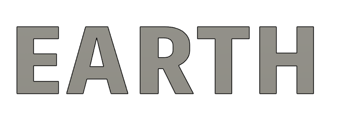

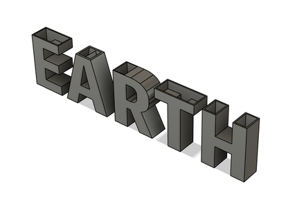

First, select a single word that resonates with you and fits your space. I chose the word "Earth" but you could do something like "Home", "Nature", etc.
Afterwards, type your chosen word in a bold, font in Fusion 360. Bold fonts work best as they provide enough volume for the planter.
Then, convert your 2D text into a 3D model by extruding it to the desired height (e.g., 60mm). Ensure that the letters are thick enough to hold soil and a plant!

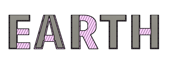

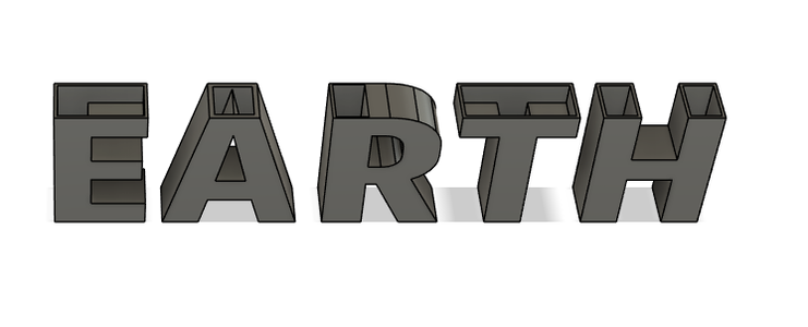

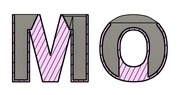

After that, hollow out the top of the letters to create space for soil and roots. The depth will depend on the plants you intend to use.

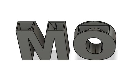

  • Note: Avoid creating overhangs (Look at the attached pictures for how I designed the letters) as they will require supports (which will be almost impossible to remove) when printing!
Afterwards, add a small hole at the bottom of each letter for drainage in order to prevent overwatering.

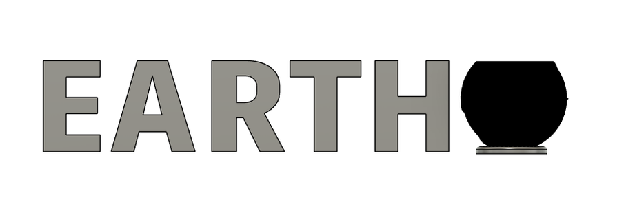

I then went a step further and got a model of Earth and hollowed it out in order to place a small plant inside!

For most letters, you will require some form of support. However, I found that Tree Supports were the easiest to remove and left little to no mess!
Once you have printed your letters, do some post-processing by removing any supports and (optionally) using some sandpaper to smooth out your 3D Print!
