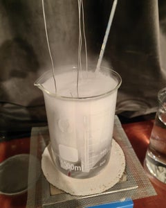

Step 6: Oxidize

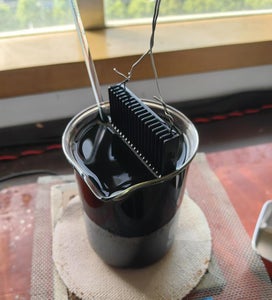

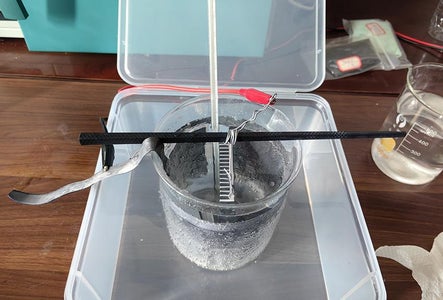

Electrolyte: Prepare sulfuric acid solution (concentration 20%) with pure water, temperature 18-22℃. Too high temperature will lead to loose oxide film, too low temperature will prolong the reaction time.

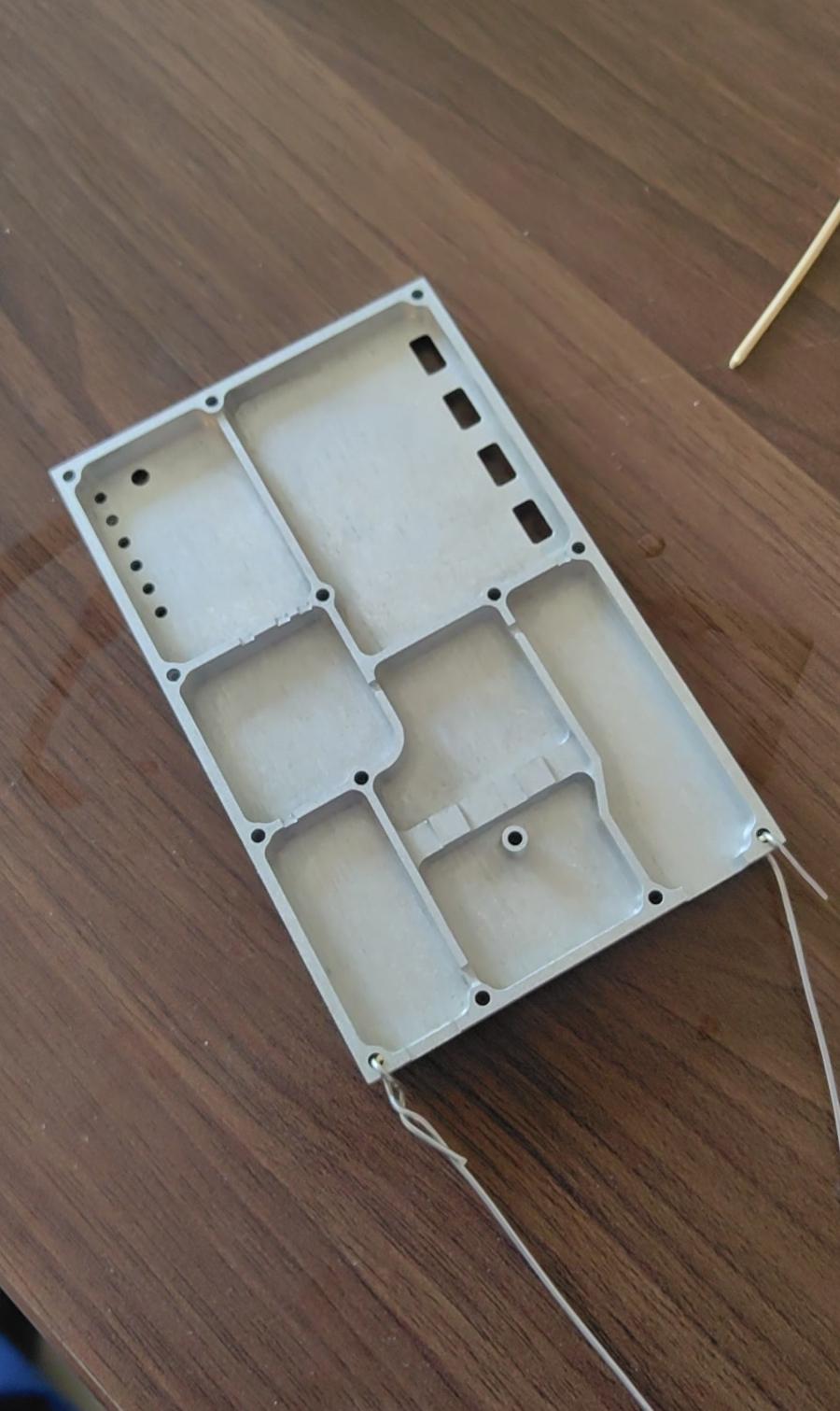

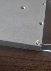

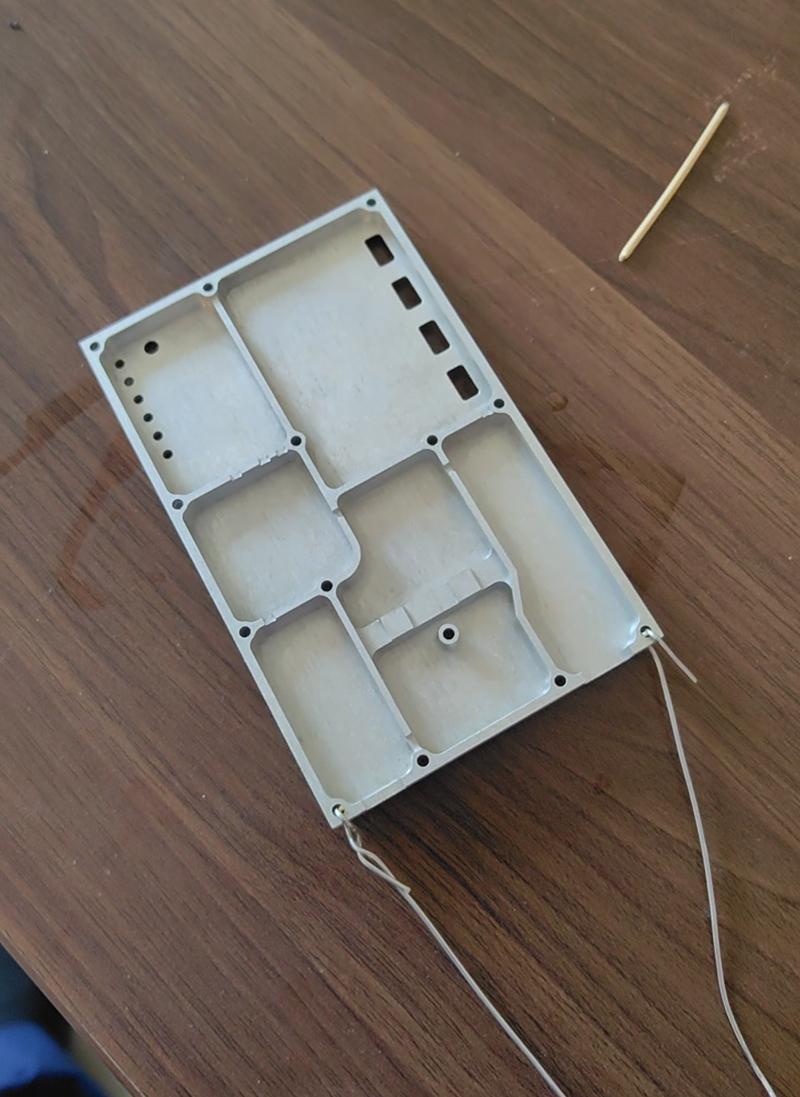

Use an aluminum workpiece as the anode. Use fine aluminum or titanium wire, bamboo sticks, silicone plugs, and other wedges to assist in clamping.
Suspend the workpiece in the electrolytic bath through hidden holes or other non-visible locations. For example, insert the aluminum wire into small holes on the workpiece.
Then, use a toothpick to forcefully tighten it. The area where the aluminum wire contacts the workpiece will not be oxidized.
Therefore, the fewer the contact points, the better—under the condition that carrying capacity and stability are ensured. Avoid placing contact points near important visible surfaces.
The cathode is made of pure lead sheet. Current density 1.2-1.8 A/dm² (to calculate the entire surface area of the workpiece), voltage 12-20 V, treatment time 30-60 minutes. The thickness of the oxide film is positively correlated with the time, and each micron film thickness requires about 3 minutes of treatment time.
Conditions can be driven by anticorrosive pump tank liquid filtration cycle, to avoid the accumulation of local aluminum ions affect the overall effect of homework intermittent mixing can be.
Operation need to wear chemical resistant gloves, goggles, etc., to avoid acid corrosion.

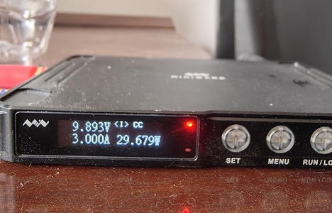

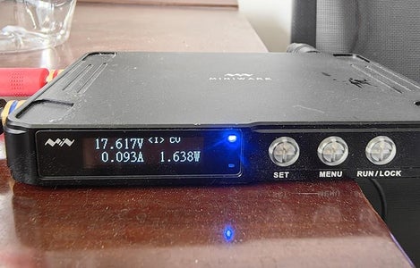

Special attention is paid to the oxidation process system will have a large number of Joule heat generation, the need for real-time monitoring of the electrolyte temperature does not exceed 22 ℃, if necessary, in the water bath into the ice cooling.
The surface area of the workpiece is about 2dm², set the voltage limit to 18V and the current limit to 3A.
With the oxidation time, the thickness of the oxide film on the surface of the workpiece gradually increases, hindering the electrolysis channel, the current will gradually decline, the cut-off current is only tens of milliamps.

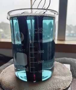

Step 9: Coloring
Dyeing solution: Use pure water to prepare water-soluble organic dye solution (light color dye dosage 2-6g/L, black or dark color 10-12g/L), firstly warm up the pure water to 80℃, slowly put in quantitative dye powder under vigorous stirring, keep warm at 80℃ for spare.
Dyeing: Depending on the required coloring depth, the aluminum workpiece will be immersed in the dyeing solution for 1-10 minutes, and the black color usually needs to be immersed for 5-7 minutes, during which the workpiece should be fully shaken or the dyeing solution should be stirred, such as the consistency of the appearance of the workpiece in multiple batches of dyeing has strict requirements, and it is necessary to strictly control the dye composition (batch), the conductivity of the water, the concentration of the dyeing solution, the temperature, the pH value, the dyeing time and the intensity of stirring and other factors.

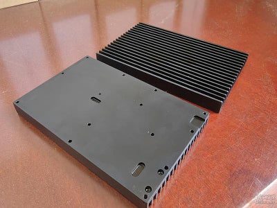

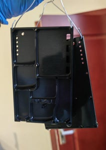

Finally the finished product:
It can be seen that even if it is a simple process, as long as you control the temperature, concentration, current density and so on, and don't skip the cumbersome water washing process, you can also get a good surface treatment effect.

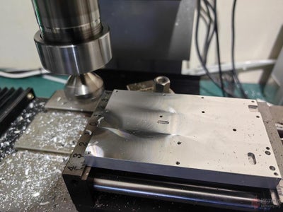

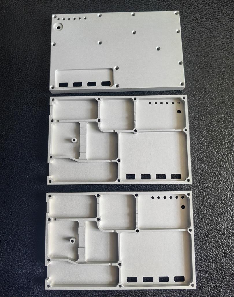

In addition, before the workpiece is anodized, add a sandblasting process, the surface has a frosted texture, does not get fingerprints, and the effect is better. Take a few more photos when you have time.
De-filming: If you are not satisfied with the color of oxidation, or there are defects on the surface after anodization and need to be re-oxidized, you can perform de-filming. Put the workpiece directly into a 10% concentration sodium hydroxide solution at 60-70℃, shake and stir continuously, and the de-filming can be completed within 1 minute. After washing and neutralization, it can be oxidized again.
After the shielding cavity is processed, it will be oxidized again. This time, it is sandblasted with 180 mesh silicon carbide to remove the knife marks.
This is the detail of the aluminum wire inserting the toothpick.

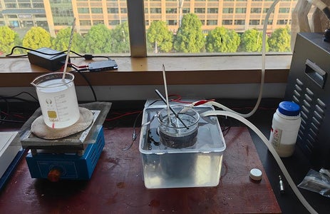

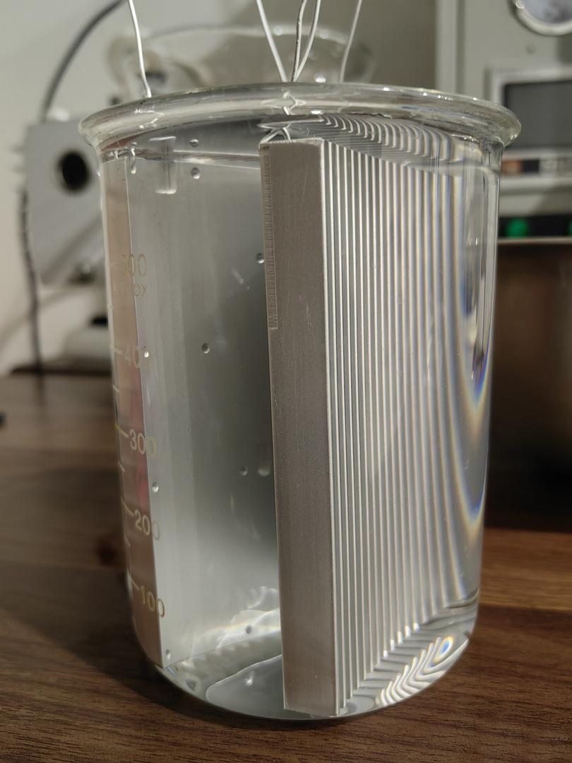

I still repeat the process on the first floor, but I add a cooling circulating water to the electrolytic tank, and I am too lazy to keep adding ice cubes.

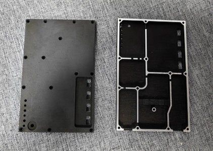

The effect after oxidation dyeing.
The finished product is still very beautiful. The matte texture after sandblasting feels very comfortable. After sealing, there will be some black and gray on the surface, which looks a bit mottled. You have to brush it hard with a brush under running water. The surface in contact with the PCB is milled off 3-5 wires with a flying knife to ensure good electrical contact

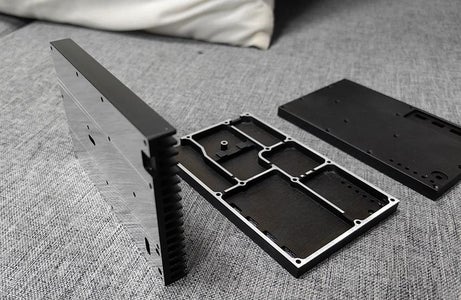

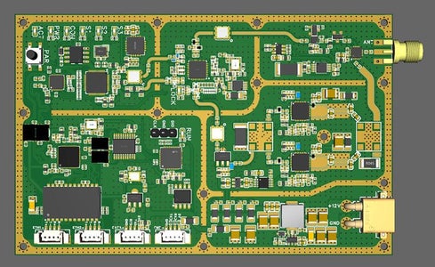

Family portrait, and it can be assembled after the PCB proofing comes back.

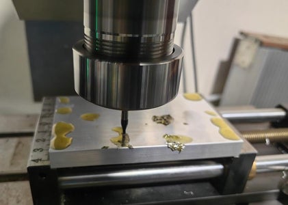

The base surface of the heat sink is also milled off 3-5 wires with a flying knife to ensure good electrical contact and heat conduction.
