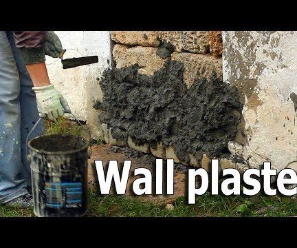

Hello friends. Now I will tell you about the technology of warming the foundation.
Step 1: Preparation
Before warming it is necessary to prepare a site for gluing the insulation.
Step 2: Remove the Ground.
Originally removed the ground. For easy operation.
Step 3: Stick the Foam.
Glue the foam on the site for insulation. Glue the insulation with special glue. Glue was applied first to the foam. Then he put it on the wall.
Step 4: Heat Insulation Treatment.
The foam should be fixed with special nails. And the remaining hole foam foam. After that, straighten the curves of the joints of the foam.
Step 5: Plaster of Foam Plastic. Angles.
On the side of the foam I will glue a special reinforcing mesh. First on the plaster sidewalls to make neat angles. Reinforcing mesh will give strength.
Step 6: Bonding the Reinforcing Mesh to the Foam.
After I finished processing the corners of the foam.
I proceed to gluing the mesh on a flat surface of the heater. This is the easiest part of the job.
Step 7: Bitumen Treatment.
After the glue has dried well. The lower part of the foundation must be treated with bitumen mastic, which would not get moisture.
Step 8: Result. Made by Own Hands.
The result was the same. The foundation is warmed and processed with mastic.
