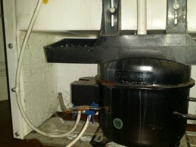

Before you start work, air gap the fridge. As in, PULL THE PLUG! That way there can't be any sudden shocks. Now open the door and check the light doesn't come on.
Ok, now go and have a cup of tea or something. Hydration is very important. This will also give the compressor, the metal lump shown in the picture, time to cool off.
The second picture shows the wiring into the compressor, but I couldn't figure out how to get the case off, there were cable strain reliefs in the way, and though it would be neat to put it in there, it gets very hot. There's no need.
We will be working about a foot away from the compressor anyway.

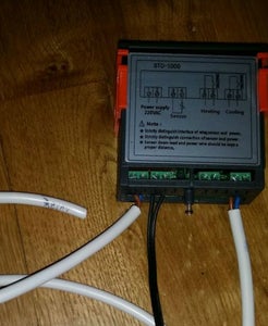

Step 5: Wire Up the PLC
The STC-1000 PLC will have come with instructions, so check those. It is pretty simple though.
Use your screwdriver to remove the wire cover, and get access to the screw connectors. (The screw comes out about 10mm, then the cover will lift off)
Determine the connection for the power, the cooling and the thermocouple temperature probe.
Wire the probe in first. Polarity doesn't matter, so just pop the the bare copper wires into the two holes and tighten them up.
Now get your new mains cable. Work out where you are putting the PLC. You will want to be able to see the temperature display. I've currently simply got it sitting on the top of the fridge freezer, some 5 feet off the ground, taped down so it can't move. Now reel off enough cable to get from the PLC to the power feed cable at the base of the fridge, and add a little bit for safety - cutting too short is a right pain. Cut a second length for the relay.
Strip the ends off the cable carefully - about 5mm of copper should be showing. Label the relay line, I used pen, but you can just use a wrap of tape on the end. Now wire those in to the PLC. Make sure you get them the right way around. Remember brown is the live and blue is the neutral. (If you've got an earth, you should wire the two earth lines together, as the PLC doesn't take the earth cable. Just use a single bit of block connector.)
Once the screws are tight, check no stray strands are bridging the wires, and no copper is showing. (a millimetre or two is fine, but no more. You can undo the screw and trim the copper then re-insert and tighten it up again) You also need to make sure you haven't tightened the screws onto the insulation, but we will check that as we go.
Locate the cable cover and split the cables apart so you can screw it back into place. There should be almost no way you could touch the back of the PLC now without a screwdriver - fingers shouldn't be able to touch bare copper!
Step 6: Find and Cut the Right Wire
The next wire is really hard to find - it's the one between the plug socket to the back of the compressor. :-)
Check it is unplugged again!
Chop the incoming mains cable about 6 inches to a foot away from the point it enters the compressor. I cut it about 4" away and it was a bit tricky at the end putting the chocbox on.
