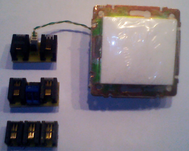

Introduction: Home Automation Project Based on 1-wire Devices
Home automation project using the following components
Arduino Mega 2560 http://arduino.cc/en/Main/arduinoBoardMega2560
Integrated circuits:
Maxim DS18B20 http://datasheets.maximintegrated.com/en/ds/DS18B20.pdf
Maxim DS2413 http://datasheets.maximintegrated.com/en/ds/DS2413.pdf
Panasonic AQH3213 http://www.panasonic-electric-works.com/peweu/en/downloads/ds_61613_en_aqh.pdf
UTP cabling with RJ11 connectors (star topology with serial buses, multiple devices on each bus)
Capable of handling:
8 1-wire buses (using dynamic class instances for the library)
256 switches
256 relays
128 temperature sensors (non-parasite mode for faster bus)
* Switch-to-relay associations are freely programmable
* No high voltage and power wires at wall switches, only 12V DC over UTP cable
* Lower surge current and electromagnetic radiation since SSRs turn on and off at zero crossing
* Switches are continuously scanned by the Arduino - as a result switching of relays/lamps work immediately just like for normal lamp switches (many home automation systems are a bit slow, with recognizable delay)
* Single 3.9 k pull-up resistors on the Arduino pins (passive pull-up solution)
* PIR movement sensors, light sensors etc. could be used as switch devices as well (monostable mode with adjustable timer)
* Relays are AC (SSR) or DC (MOSFET) for LED lighting etc.
* Current limitation: SSR maximum current is 1.2A therefore load should be less than 250W (at 220V AC)
* Temperature sensors readable anytime - they are "hidden" in wall switches
* Device data and settings are stored in the EEPROM of the Arduino board - system works even after power outage
* Changes are programmed by serial commands from PC, however it works standalone as well without a PC connected
* By design complex functions which are not time critical should be handled on the PC level instead of the micro controller - e.g activation of heating based on averaged temperature values

Since both switches and relay use DS2413 chips they are differentiated when a new device is added. A routine activates transistor A for a short period. In case the remote device is a relay logical LOW will be detected on the PIO B input since the two pins are connected.
