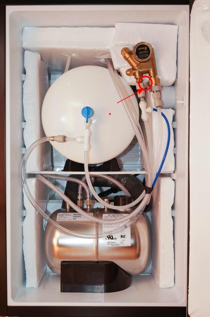

Step 4: RO Pressure Tank
This is the large white tank on the top shelf of the fridge*. Normally this sits under the sink but by keeping the tank in the fridge it ensures the water feeding the carbonator is pre-chilled. Water temperature is quite important when dispensing seltzer as it will lose its carbonation fairly quickly if not cold. I tried filling a 2L bottle with room temperature seltzer, capping it right away and chilling in the fridge and the results were lackluster. Others have had success simply chilling the water in the pressure tank hooked directly to the city water supply. If you don’t plan on dispensing large volumes at once, say when you have guests over, then it should be perfectly fine.
The RO tank serves 2 purposes. It accumulates the RO water created (being it's a slow process) and ensures that water can feed the tap/carbonator pump with pressure. Without this your water supply would be a mere trickle as the filtered water is created. This tank is included with the RO system.
*A heavy load on a glass shelf
The RO tank when full at ~40 psi weighs about 30 lbs. The glass shelf should be able to handle the weight load as long as it’s distributed evenly with the included base but the fridge’s manual specify no maximum weight limit. I’ve tested it bypassing the RO system with the full 65 psi tap water supply (weighing 37 lbs) to no ill effect. Those that are more risk averse may want to replace the glass shelf with a plywood board instead.
Step 5: Carbonator
The carbonator is meant to work with a soda fountain dispenser, chiller, syrups, etc but it can be a standalone unit. It’s actually quite a simple setup. Basically a 5.3L stainless steel pressure tank has a float sensor that triggers an electric motor and pump. When the water level is low the pump runs forcing water to mix with the CO2. In a commercial environment the carbonator passes room temperature seltzer to the soda fountain which chills it before dispensing and mixing with syrup. This home configuration chills the water in both the RO tank and the pressure tank rather than afterward saving space and simplifying the setup.
The McCann's carbonator comes with a plastic base and a rigid stainless steel tube connecting the pump to the tank. I had to disassemble the tube and cut the base in half with an angle grinder so the tank can still sit properly. There are actually 2 welded bolts that stick out from the bottom of the tank which mount to the base. I was thinking about simply cutting the bolts but I figure cutting the base in half instead was better as the tank needs to be positioned correctly for the float sensor to work. I suppose you can use a table saw to complete this step but I ended up using a jawhorse to hold the base in position with an angle grinder to make the cut. The cut can be fairly deep so use a new cut off wheel and wear long heat resistant clothing, eye protection, etc as the ABS plastic can melt and spray everywhere. To finish the exposed cut I mashed the face of the wheel to the edge, melting and smoothing out the plastic.
I also had to extend the electrical connection from the float sensor to the motor thus I soldered and spliced in a spare computer extension cord. Use sealant to waterproof the connection since this is a water appliance after all. I still kept the original (and proprietary) connector so disconnection from the tank is possible. I ended up extending the carbonator tank end but extending the motor end would make more sense. This is simply because of the awkward positioning of the connection once the motor is mounted in the fridge.
Hooking up the carbonator is very straight forward. It has a water inlet at the pump and two soda outlets and a co2 inlet on the tank. Once those are all connected along with the power it's all ready to go. In the materials and cost spreadsheet I outlined the fittings I used and its purpose.
When you’re ready to start it up, purge the tank of air by turning on your water supply and flipping the pressure relief valve up. You’ll hear a hiss as the gas escapes and the water fills the tank. Keep a towel over the valve with your hand ready to close it once water starts spraying out. After purging the tank of air you can turn on the co2 valve and start dispensing water. Simply test to ensure everything works. The co2 pressure must be higher than the incoming water pressure. If it isn’t it won’t work properly. Turn on the faucet and simply let it run until your pump turns on. If everything checks out, you just need to flush out the system a few times before it’s ready to go. Your first several tanks of water will most likely be tainted. I bought a brand new tank and found a metallic taste in the water. I had to flush it out perhaps 5-10 times before nothing was noticeable.

Step 7: Tubing and Connections
With my setup, I have the 1/4” OD tubing (blue) from the RO system teed and transitioned to 3/8” OD tubing to the RO tank and carbonator pump inlet line. The carbonator manual recommends a minimum 3/8” ID hose for the water supply but so far I’m not encountering any issues. This may be because the pressure tank is connected to the pump inside the fridge (top right) with a short length of tube. The short length means less resistance for the water flow. I initially wanted to put the pump outside the fridge to keep it at room temperature but the motor and pump can be quite loud. Many commercial establishments have a separate room to house all the back-end equipment and isolate the noise as this isn't the case for me I was considering building a lead lined MDF enclosure filled with mineral wool insulation. In a quiet home environment, noise is more noticeable thus with available room inside the fridge I decided to take advantage of it. This may not be recommended but it simplifies my setup.* It creates a clean simple solution as only 1 tube connects the RO system to the fridge and one less component is strung separately. The airtight enclosure of the fridge serves to isolate and contain the noise. The motor is hung upside down using metal hanger straps mounted to the beer tower bolts and the fridge’s original evaporator plate anchors.
I’ve used push-fit fittings and tubing from the tap up to the pump which then transitions to 3/8" ID braided hose from the pump outlet to the carbonator tank inlet. The soda outlet to the beer faucet and co2 tank to the co2 inlet both use 1/4" braided hose. I initially had 3/8" OD tubing connecting the carbonator tank and the pump outlet but due to the carbonator tank's inlet fitting facing the back of the fridge the line froze a few times if the fridge was on for an extended period of time. I ended up swapping to a 3/8" flare to 3/8" hose barb elbow allowing me to route the line to the side and front of the fridge rather than to the back under the evaporator plate. The more flexible line, larger hose diameter and rerouted line so far has not developed any problems.
**A word of caution
As there are electronics in the motor and most likely grease lubricating everything, I wouldn't necessarily recommend this configuration for everyone. The grease could seize making the motor more difficult to run and moisture could condense and short out the electronics. As this is a dedicated seltzer fridge, I don't foresee myself opening and closing the door often. This sealed environment should minimize the moisture inside the fridge and cause most of the vapor to condensate on the evaporator plates instead of the motor. When defrosting I just have to remember to unplug the fridge and keep the door closed until the ice defrosts. This way the room's warm moist air won't settle on the cold motor. I’ve also purchased some colour changing silicone gel desiccant to put inside. As an additional precaution I’ve plugged the carbonator motor into a GFCI outlet.
