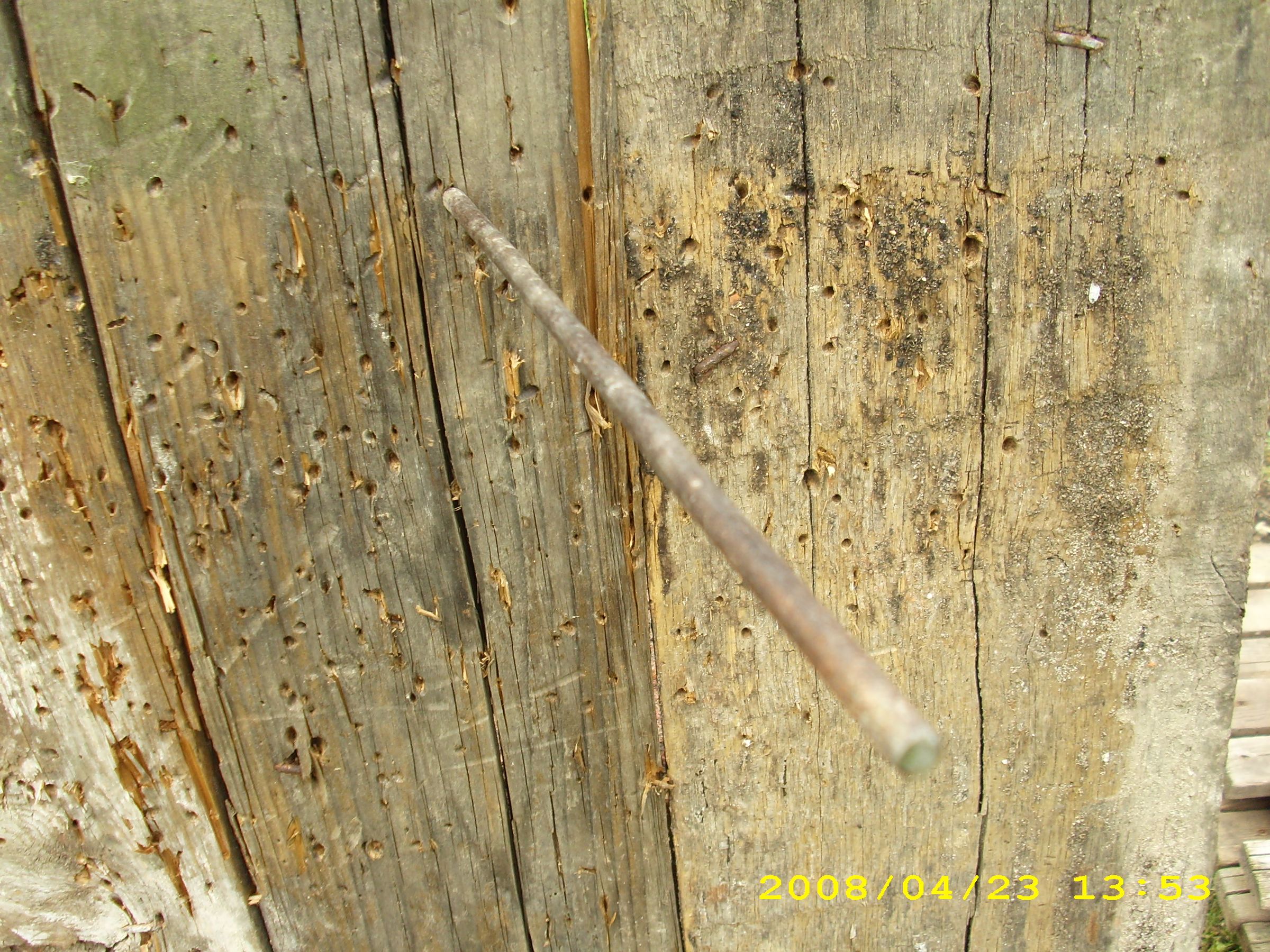

You must find some place that is high enough for the main part to be secured. Main reason for hight is range of exercises you could or couldn't do. If you have long arms like I do, you won't be able to do all the exercises. I choose wooden beam in my shed.
