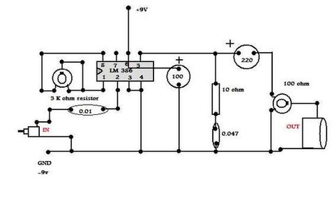

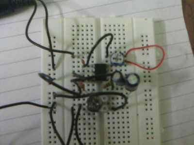

Step 2: Circuit Building
connect the circuit as showwn in following diagrams:
if u dont know about 3 pins of audio jack then search on google.....
(NOTE: U HAVEN'T CONNECT THE GROUND PIN (LONGEST PIN IN JACK) IN CIRCUIT.. )
Step 3: Testing & Finishing
nw test ur system by connecting ur audio device to male jack n headphones to female jack or directly to speakers....
use screw driver to change resistances which changes tones & gain, volumes of ur song & makes it more coool.........!!!!!!!!!
