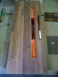

So I started with a sheet of Marine Plywood that I cut to the right size (the dimensions of the frame i the thickness of the boards (12mm) around the whole thing (so I could frame it with jarrah too)
To cut it to size all I used was a standard drop saw.
After cutting the sheet to size I cut the groove away from the first board and top nailed that to the plywood (note at every step I used flooring glue to secure the timber to the plywood)
After setting the first board I used what australians call a 'secret nailer' basically it's a nail gun that fires small nails at a approx 45 degree angle through the tongue of the timber.
Using one of these means the end result is that no nails are seen except for the first and end piece that are top nailed.
The picture attached is when I had laid a fair few boards and cut the hole where the dual glazed glass was supposed to go.

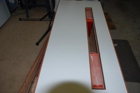

Once the external timber had been laid I cut the top and bottom to size (to accomodate inlaying jarrah inside it.
I just cut it using a circular saw and did a test fitting of the door handle and timber to frame the window.
Once it was cut I flipped the door around, at this stage there was a small change of plan... after looking at it I decided that having the same look on the inside was not going to match what we had in mind for the inside of the house..
After fitting jarrah edges around the window frame and around the door. After test fitting everything I ended up buying a sheet of oak and cut it to size and attached it (once the sides had been inlayed).
Step 3: Tidying Up the Inside
After fitting the sheet around everything I painted the oak white and left a jarrah contrast around everything.

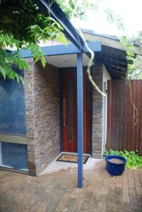

Step 5: Door Install and Adding Ledgestone Around the Frame.
Firstly this door is heavy... it took 2 people to move it and I had to buy commercial ball bearing hinges to hold it up.
Once the door was in I covered the outside of the entrance with a cement sheet and started laying the ledgestone.
After running an initial row that I knew was leve I started to lay approximately 3 rows of stone until I was done.
It's probably worth noting that using a small grinder with a ceramic cutting disc is perfect.. Corners are difficult but I chose to use a hashing pattern where both sides of the tiles overlap.
I hope you all enjoy the end result and feel comfortable trying to make a door yourself :)
