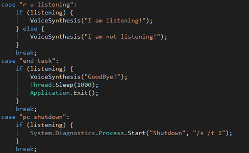

Step 6: Learn Her Close Herself, Tell You Her Status and Shutdown the Computer
This part of the code is pretty simple I do not think that any extra explanation is required since the code can be understood easily.
