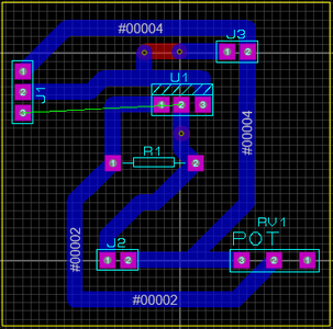

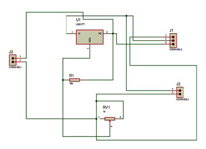

Step 2: Electrical Schematic
In the electronic part we used a PCB to centralize the wires of all components. The design of the board can be found above.
If you don't want to put the circuit in a PCB, you can either weld it directly into components or use a mini protoboard, following the circuit in the first or fourth picture.
Here you can find all the files related to confection of the board through Proteus software and its execution with a CNC, including the gerber and G code files (used to mill te board).

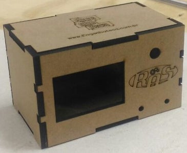

Step 3: External Design
The DXF models of the digital source box are on our page of thingiverse: DXF MODELS
The outer dimensions of the box are: 100X60X60 mm (L x H x W).
We developed that model using Solidworks and a Laser cutter to make the cuts in MDF. But you can make your own model for the external design. Always paying attention to the size of the components so that they fit right into the holes.
In our source the holes for the components have the following measures:
  • Potentiometer: 7mm circular hole.
  • Switch button: 21,4 x 12 mm (L x H)
  • Alligator clips: 2mm circular hole.
  • Female P4 connector: 7mm circular hole.
  • Digital Voltimeter: 45,2 x 29 mm (L x H)
Step 4: Gathering
When the box and circuit are ready, you need to put the two together.
Begin by placing the base of the carton and the front of the unit (with all components already attached). Then place the right and the back side of the source. Finally place the left side and top, always making sure that everything is tight.
Note: If the straps do not get too tightly attached you can pass some glue.

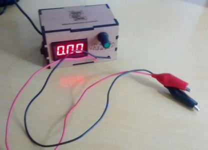

Step 5: Results
This is the final result of our digital source, with it you can connect all types of source with input P4 (12V 1A, 12 2A, 9V 1A etc ...) and have the desired output. All this with a cost that does not exceed $ 20.
We intend to develop a version 2 of this source with many improvements in functionalities and design.
Keep waiting...
Note: Soon we will put some videos and photos of the source operation.
