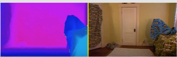

Step 3: Building the Studio
Place the Cameras in any direction,Just place it anywhere but 1 camera should be facing you and the other camera should be opposite to the other.th cameras should see your floor.
connect the cameras to the computer
Thats it !
Step 4: Installing the Softwares
Go to http://ipisoft.com/download/ download 2 softwares.
Install it.
on the installing of the 2nd software which is ipi recorder.tick which camera you are using
if you are using kinect tick kinect and install the driver
if you are using ps3eye camera tick it and install the driver.
using the 2 camera tick the 2 driver and install it.

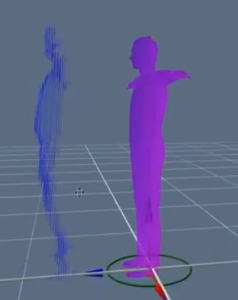

Step 6: Using the IPi MocapStudio
The recorder will take you to the iPi mocapstudio
then a window will open New project Wizard.
Select the gender Male or Female and specify an Actual height of you.Continue
It will show you a Rose man.stand to it also it shows you the animation that you have been captured using the recorder.
you can line-up the actor using the move tool on the toolbar.
and turn of the video on the toolbar.move it.
you can adjust the actor bon the actor window right side of the software.
On the tracking Session press the track forward button
it will take some minutes to track.
play the animation
Whoalla!!
