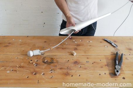

Step 8: Wire the Lamp
In order to thread the wire through the bat, I had to disassemble and remove the socket. I then threaded the wire and reassembled the socket.

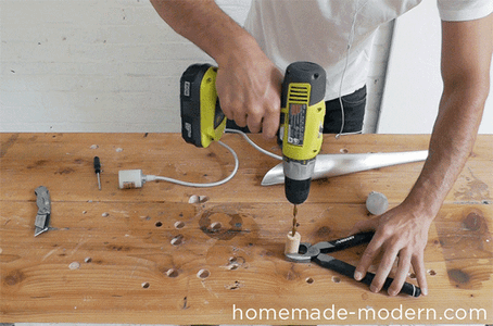

Step 9: Make a Cork Stopper
I drilled a hole through the wine cork and cut it down so that it fit snuggly in the small end of the bat. In order to get the cork stopper around the cord, I had to cut through one side of the donut shaped cork so that I could stretch it around the cord.
Step 10: Assemble + Hang
I pulled the socket and wedged the cork stopper into place. Plug in the lamp and turn it on!
