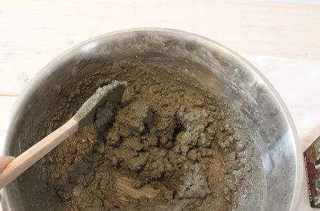

Step 6: Mix the Concrete
Follow the manufacturer’s directions on the proportion of water to cement. Beginners tend to add too much water. You want the mixture to be the consistency of cookie dough. Mix it thoroughly and then mix it some more. You want every grain of sand to be wet without adding too much water.
