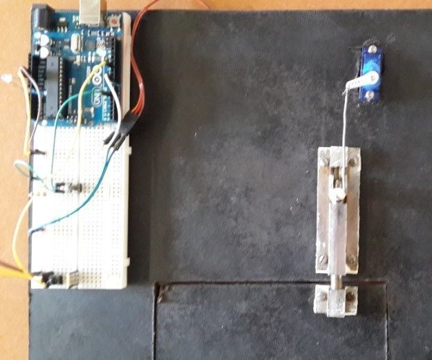

Step 7: System Design
The figure shows the systematic breakdown of this project. There are two forms of communication in this project, namely wireless and wired connections. The wireless communication will be made possible by the Bluetooth module. The HC-06 Bluetooth module will enable the android smartphone to communicate with the Arduino system wirelessly. The wired connections will be the office electrical appliances that will be switched on/off by the Arduino system.

In this Project the android phone that will be used as the remote control is a Samsung Galaxy S4. The application on the smartphone that will be used is ArduDroid.
ArduDroid is a simple Android app that allows the pins on the Arduino Uno board to be controlled wirelessly from a smartphone. ArduDroid uses an easy to understand user interface to control the Arduino Uno’s digital and PWM pins. It also allows the user to send text commands to the Arduino Uno and receive data from the Arduino via the Bluetooth serial module.
In this Project the Digital Pin Function is only required to make the system work, so the Arduino-Uno Board will only be programmed to support that feature.

Step 11: Connecting the Arduino Uno and the Bluetooth Module
A connection between the Arduino-Uno and the Bluetooth module is required in order to enable the android to control the Arduino-Uno.
Firstly, the VCC pin of the Bluetooth module must be connected to the VCC port in the Arduino-Uno board. Secondly, the GND pin of the Bluetooth module must be connected to the GND port in the Arduino-Uno board. Lastly, the receiver of the Bluetooth module must be connected to the transmitter of the Arduino-Uno board and the transmitter of the Bluetooth module must be connected to the receiver of the Arduino-Uno board. Table 3.7 shows the process.
Step 12: Testing the Connection
After installing the ArduDroid app on the phone from the Google play store and connecting the Arduino-Uno board with the Bluetooth module, a test is required to ensure that the smartphone is interacting with the Arduino via the Bluetooth module.
The steps for the connection test is carried out as follows:
· Open the ArduDroid app on the android device.
· Search for Bluetooth devices in the ArduDroid app.
· Connect to the Bluetooth module.
· If the light on the Bluetooth module stops blinking it means that a connection is established. If the light on the Bluetooth Module continues to blink it means that it’s not connecting and the wiring needs to be checked.
Step 13: Connecting the Electrical Appliances to the Relay Module
Once the smartphone is connected to the Arduino the electrical appliances can be connected to the Arduino via the relay module. Flex wire and connector blocks is used to connect the positive terminal of the electrical appliances to the normally open port in the relay module as the aim of the project is to make the output active a high. The negative wire of the appliances connects to the power source. Then IN port of the specific relay is connected to the desired Arduino Uno port. The same procedure is applied for the other appliances using different relays and different Arduino Uno ports.
Once all the connections of the electrical appliances are completed and the smartphone is connected to the Bluetooth module, the electrical appliances can now be controlled wirelessly using the smartphone.
Step 14: RESULTS
The Home/Office Automation project was successful and applied in the office area at my workplace. It was cost effective and user friendly. All the staff members knew how to use the app to control the system. All the parts needed was cheap and the equipment required was owned by myself.
Step 15: PROBLEMS ENCOUNTERED
Some problems and issues were encountered during the build of this project. The Bluetooth connection between the smartphone and the Arduino-Uno board was unsuccessful in the early stages of this project. The cause of this problem was that the xbee Bluetooth module was used. The problem was solved by an online forum which suggested to use the HC-06 Bluetooth module instead of the xbee Bluetooth module.
The second problem encountered was trying to using individual relays and connecting them by soldering them to make my own relay module. It was a problem as the holes didn’t align properly with the pins of the relays. Also soldering so many pins can cause a lot of unwanted connection joints and shorts. Therefore, a relay module is used.
