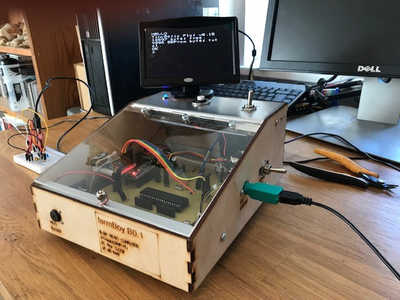

Introduction: Homebrew 8-Bit Computer With TinyBASIC and ATMEGA1284P
I have assembled many desktop computers over the years but it's just not the same when you don't use a soldering iron! I wanted to build a computer from scratch for a long long time because I find when you have a go at building something go gain a better knowledge of it's inner workings. I have previously built homebrew computer variants using 6502 processors however these systems are not friendly for the novice or intermediate maker. I have also finally joined a hackspace (@NHackspace) so I wanted to put all my hacking skills to the test. This simple computer I built is based on an Arduino running TinyBASIC which has been done before but I wanted to do a complete build with homebuilt PCB, keyboard interface, monitor / tv output, sound and SD card storage. By day I am an industrial controls engineer and tend to use very robust proven modules in control systems rather than handmade parts. I build homebrew computers and electronics as a hobbyist and not a computer scientist or computer engineer so I am going to highlight all the "gotcha's! I came across doing this build.
I decide to base this 8-bit computer on the ATMEGA1284P-PU chip as it has a high spec for an Arduino compatible 8-bit micro controller, the basic specification is as follows:

Step 3: Enclosure
The enclosure build was very fun and used many of the skills and resources available in a hackspace. The enclosure itself comprises of a laser cut 3mm wedge shaped plywood box with laser cut acrylic base and hinged lid so that the PCB can be viewed. The top platform of the enclosure was manufactured from sheet aluminium bent using a sheet metal brake.
The PCB is mounted on a 3D Printed bracket manufactured from PLA. This was designed using Autodesk Fusion360 and then sliced using Cura before being printed on an Ender 3 Pro. This print took quite along time, about 4 hours. The same process was done to make a bracket for the SD card shield. I found Fusion 360 pretty user friendly as I had used Autodesk Inventor professionally in the past and it has a similar feel. My 9-year old son is fascinated by 3D printing so he has dived straight into Fusion 360, he thinks of it like playing Minecraft!
15mm x 15mm aluminium extrusions were utilised to hold the enclosure together.

Step 5: Final Testing and Improvements
When all the components were built and inspected the complete system was finally assembled and tested. To test the system i wrote a few programmes in BASIC. A good test programme was a programme I wrote to find all the Prime Numbers up to a value inputted by the user. This is a great little programme for testing the performance of the computer. It is slightly more challenging than a normal because TinyBASIC has such a reduced instruction set. It has no "mod" which is a function that gives you the remainder when dividing two numbers. This is very useful for finding Primes, in our case it just took a bit more maths. I found it took about 5 minutes to calculate all the Primes up to 1000. This little programme was ported to several other retro computers in the hackspace and the race was on!
Another programme was a a simple tune to test out the Piezo buzzer and tone function. This was good fun and surprisingly good. I have included the Basic programmes I have written for others to try.
The biggest improvement I would make would be to the power supply. When testing the project I used a mobile phone power bank which provided no problems at all. When I moved to my bench top power supply I had problems which I suspect were caused by AC ripple. This was a big "gotcha" and easily solved by using a 9v battery as the power source. Although the power supply stage has two reservoir capacitors to help remove AC ripple, I think it would also be useful to include a low pass filter stage to remove any remaining AC ripple and improve the stabilisation of the DC output voltage under load conditions. I would also add 0.1uF decoupling capacitors to the power input on the Arduino Nano and ATmega1284p. A decoupling is there to supress high-frequency noise in power supply signals.
Note: It's called the farmBoy B0.1 because it was built my workshop in rural Norfolk, England, which was formally a barn used for raising cattle.
