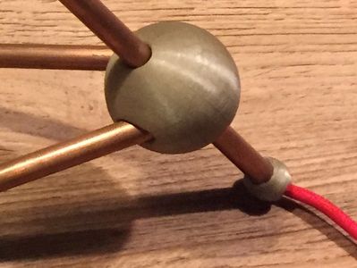

1. a power plug with switch from your local handy shop
2. a lamp fitting with nice wire. Ikea SEKOND cord set.
3. 3D printed part - bottom end
4. 3D printed part - connector
5. Copper tube from 12mm outer diameter - 470mm - 1X
6. Copper tube from 12mm outer diameter - 200mm - 2X
7. 3D printed part - tube end
8. 3D printed part - lampshade (or purchase one of preference that fits the )
9. Light bulb E27. (halogen or other low heat bulbs) Don't put a standard bulb in it (too hot for the 3D print)!!!!!! Small bulb from Ikea, forgot the exact details.
10. 3D printed part - top end
*. a drill of 12mm, to finish the printed 12mm connections.

Step 3: Print All the 3D Parts
There are 4 different parts to be printed to mount the light.
- 3D printed part - connector
- 3D printed part - bottom end
- 3D printed part - top end
There is one lampshade you can use, or design your own or purchase one you like that fits the E27 bulb holder from Ikea.
- 3D printed part - lampshade
I printed this on a Ultimaker 1 with no problem.
The bottom end and the top end allow the cable to go trough. The bottom end allows the red wire to bend away when it is on the table. The tube end is closed.
Step 4: Rag It All Together
Get the parts in the right order over the power cord. If it is necessary you can use a 12mm drill to clean the holes from the connector part after 3D printing to make sure the copper pipe can get through/in.
Mount the power plug/switch of your choice on the power cord.
The 3D components at the end of the copper fit, but when you feel ok with the result it is probably better to fix glue them together.
Mount the two copper feeds in the connector to allow it to stand.
Step 5: Final Result.
The lamp is ready.
You can move it to adjust the height of the lighting.
