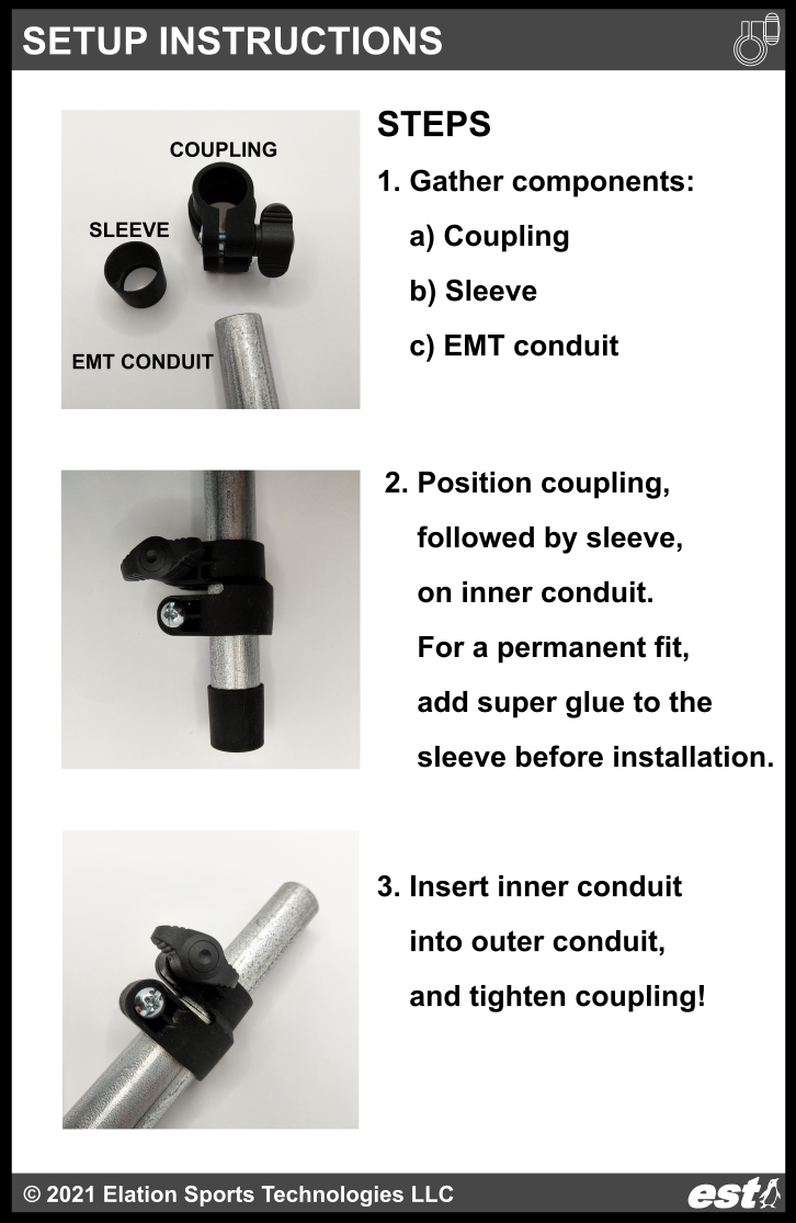

Step 2: Assemble the Telescoping Portion
These EMT conduit telescoping clamps make it easy to create a telescoping pole out of EMT conduit! They're made of injection-molded UV-resistant and durable plastic which is suitable for outdoor use, and they clamp onto the outside of the conduit - no drilling required!
